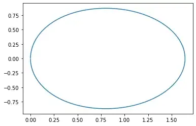

If one plots the values of $f(x)$ in the complex plane, at a first look the result is quite similar to a circle $(|x| \lt 100)$

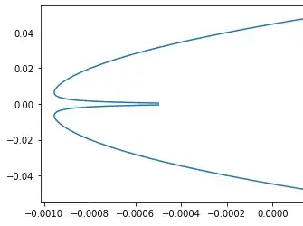

But a closer analysis shows the following behavior for large values of $|x|\;(20 \lt |x| \lt 1000)$
I ask if there are theoretical references that explain the graphs obtained.
