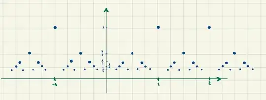

This is roughly what the graph of $f$ looks like:
Note that I drew only a few blue points, representing rational values for $x$. In reality, there are infinite such points smaller than the ones I drew. They all have $f(x)>0$.
