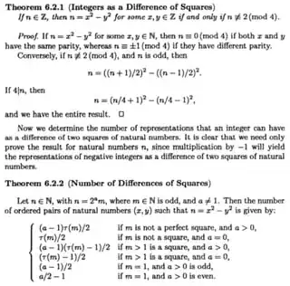

is a so-called "Norm-Form Equation". Hence in our case, we have the special case $D=1$. However, as simple as the equation looks, it does not appear to be. For example Richard A. Mollin involves in his Theorem 6.2.2 the divisor function which is not a very efficient operation:

    Given $n$, you want to know if there exists a $y$ and an $x$ such that $n + y^2 = x^2$, or what is the same thing, $n = x^2 - y^2 = (x+y)(x-y)$. If $n$ is odd, the answer is always "yes": set $x = \frac{1}{2}(n+1)$ and $y = \frac{1}{2}(n-1)$. – Eric Towers Jan 26 '22 at 21:58
    If $n$ is divisible by $4$, the answer is always "yes": set $x = \frac{1}{4}(n+4)$ and $y = \frac{1}{4}(n-4)$. – Eric Towers Jan 26 '22 at 22:02
    How is checking whether $n$ has the remainder $2$ from division by $4$ "not very efficient"? Are you familiar with the division algorithm? – Conifold Jan 26 '22 at 22:12
    ...The answer is: check the last two digits of $n$. If it divides by four the remainder is two, there is no such $y$. – JetfiRex Jan 26 '22 at 22:53

Summarizing the comments; your question can be rephrased as:
Can we efficiently determine whether a given positive integer $n$ is of the form $n=x^2-y^2$, for some integer $x$ and $y$?
The answer is yes; a positive integer $n$ is of this form if and only if $n\not\equiv2\pmod{4}$. This has been asked here before, e.g. this question.
