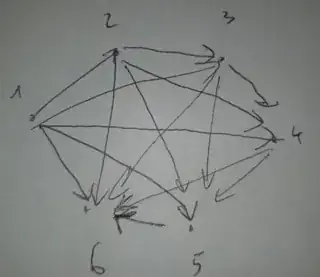

For example the answer of Maximum number of edges in a directed graph on $n$ vertices without cycles is not satisfying because, here with $n=6$,
  • 5 edges arrive on point #6
  • 0 edges are arriving on point #1
so here $\max N(j) / \min N(j) = +\infty$.
