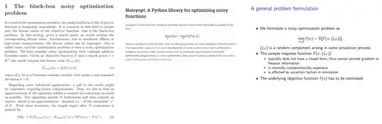

I am trying to better understand the meaning of "noise" with regards to function optimization - specifically, why "Noisy" functions are more difficult to optimize compared to "Non-Noisy" functions.

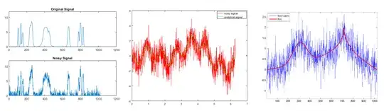

Up until now, I always thought of "noise" from a signal processing standpoint: for example - how to remove and filter out the noise component from some signal:

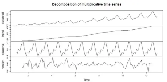

I also generally think of this in the context of Time Series Analysis, where a time series is separated into non-random components (e.g. seasonal) and random components (e.g. noise):
In both of these above cases, "Noise" is viewed as something with inherent "negative connotations", as something undesirable which is either hindering or further complicating the end goal of (usually) a forecasting or engineering project.
However, I am interested in "noise" from more of a Machine Learning and Optimization perspective. For instance, (I am not sure if this is correct) I have heard that since the "loss functions" of Machine Learning algorithms are always modelling a random variable - thus, any "loss function" of a Machine Learning algorithm is always considered to be a "noisy function":
