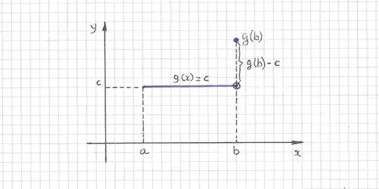

Let $f$ be a continuous function and $g$ a constant function $g(x)=c$ in the interval $[a,b[$ and $g(b)$ its value at $x=b$. Then the Riemann-Stieltjes integral
$$ \begin{equation*} \int_{a}^{b}f(x)\,dg(x)=f(b)\underset{\text{jump of }g(x)\text{ at }x=b}{\underbrace{\left( g(b)-c\right) }}.\tag{$\ast$} \end{equation*} $$
In your case $f(x)=x$ and $g(x)$ is the floor function $g(x)=\left\lfloor x\right\rfloor $. Then for $n\in\mathbb{Z}$ $$ \begin{eqnarray*} g(x)&=&\left\lfloor x\right\rfloor =n,\quad\text{for } x\in [n,n+1[,\\ g(n+1)&=&\left\lfloor n+1\right\rfloor =n+1. \end{eqnarray*} $$
The jump of $g(x)$ at $x=n+1$ is equal to $1$:
$$g(n+1)-n=\left\lfloor n+1\right\rfloor - n =1.$$
By $(\ast)$ we have $$ \begin{eqnarray*} \int_{n}^{n+1}x\,d\left\lfloor x\right\rfloor &=&(n+1)(1)=n+1, \\ \int_{n}^{n+k}x\,d\left\lfloor x\right\rfloor &=&\sum_{m=1}^{k}n+m=nk+\frac{ k(k+1)}{2}, \\ \int_{-1}^{3}x\,d\left\lfloor x\right\rfloor &=&\sum_{m=1}^{4}-1+m=6, \end{eqnarray*} $$
and $$ \begin{eqnarray*} \int_{-1.2}^{-1}x\,d\left\lfloor x\right\rfloor &=&(-1)(1)=-1, \\ && \\ \int_{3}^{3.9}x\,d\left\lfloor x\right\rfloor &=&3.9\left( 3-3\right) =0,\text{ the jump of $g(x)=\left\lfloor x\right\rfloor$ at $x=3.9$ is $0$}. \end{eqnarray*} $$ Therefore the given integral evaluates as: $$ \begin{eqnarray*} \int_{-1.2}^{3.9}x\,d\left\lfloor x\right\rfloor &=&\int_{-1.2}^{-1}x\,d\left\lfloor x\right\rfloor +\int_{-1}^{3}x\,d\left\lfloor x\right\rfloor +\int_{3}^{3.9}x\,d\left\lfloor x\right\rfloor , \\ &=&-1+6+0=5. \end{eqnarray*} $$
