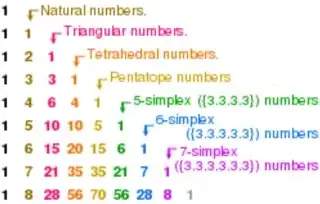

Geometrically, this expression can be interpreted as the number of spheres you need to stack to form an $n$-dimensional simplex with $i_n$ "rows" of spheres. For instance, the case $n=2$ produces triangular numbers, $n=3$ produces tetrahedral numbers, and so on. They appear as entries of the $n$th column (counting from $0$) of a left-justified Pascal's triangle:
The identity can be proven through a straightforward inductive combinatorial argument. We need to show for $n=0,1,2,..$ that
$$\sum_{i_{n}=1}^{i_{n+1}}{i_n+n-1\choose n}={i_{n+1}+n\choose n+1}.$$
The case $n=0$ is trivial. Now observe in general, the RHS is the number of ways $n+1$ numbers can be chosen from the set $\{1,2,...,i_{n+1}+n\}.$ Meanwhile, we can also enumerate this as
-The number of ways we can choose $n+1$ numbers having "$1$" as the smallest number (giving ${i_{n+1}+n-1\choose n}$ free choices for the other numbers), plus
-The number of ways we can choose $n+1$ numbers having "$2$" as the smallest number (giving ${i_{n+1}+n-2\choose n}$ free choices for the other numbers), plus $$\vdots $$ -The number of ways we can choose $n+1$ numbers having "$i_{n+1}$" as the smallest number (giving ${n\choose n}$ free choices for the other numbers),
all of which is the LHS.
