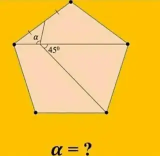

Here is the question:
I have been trying this out for an hour, and I still dont know how to do it. Here's my progress: I'm stuck in this exact position and I dont know what to do next.
Can anyone help?

    Angle-chasing, the sine rule and a scientific calculator should get you $\alpha=99^\circ$, and this is equivalent to the bisector dividing the side into the same angles already achieved on the diagonal by the line segment that's neither a side nor a diagonal. If you want help proving this, try labeling some points so future contributions can be less confusing than what I've just said. – J.G. Jan 09 '22 at 14:11
    I do not understand your progress. That's just the same diagram as the original. You need to tell us something beyond it. For example, if it is a pentagon with side as $1$, what is the distance from the vertex to the intersection point? Also your question is not well written. $\alpha$ could be any angle unless you tell more. – Math Lover Jan 09 '22 at 15:05

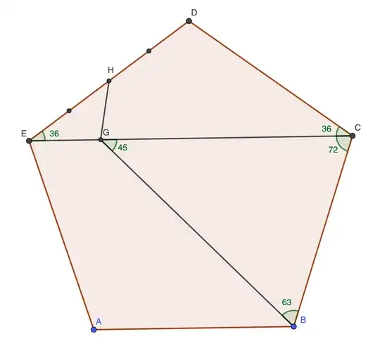

$$\triangle BCG\implies\frac{BC}{\sin 45^\circ}=\frac{CG}{\sin63^\circ}\implies CG=a\frac{\sin63^\circ}{\sin45^\circ}$$
$$CG=a\frac{\sin45^\circ\cos18^\circ+\cos45^\circ\sin18^\circ}{\sin45^\circ}=a(\cos18^\circ+\sin18^\circ)\tag{1}$$
$$EC=2a\cos36^\circ=2a(\cos^2 18^\circ-\sin^2 18^\circ)\tag{2}$$
$$ (1) \land (2) \implies EG=EC-CG=a(2\cos^2 18^\circ-2\sin^2 18^\circ-\cos18^\circ-\sin18^\circ)\tag{3}$$
$$\triangle EGH\ (\angle EGH=\alpha) \implies \frac{EH}{\sin\alpha}=\frac{a}{2\sin\alpha}=\frac{EG}{\sin(180^\circ-36^\circ-\alpha)}=\frac{EG}{\sin(36^\circ+\alpha)}$$
$$\frac{a \sin(36^\circ+\alpha)}{2\sin\alpha}=EG=a(2\cos^2 18^\circ-2\sin^2 18^\circ-\cos18^\circ+\sin18^\circ)$$
$$\frac{\sin36^\circ\cos\alpha+\cos36^\circ\sin\alpha}{2\sin\alpha}=2\cos^2 18^\circ-2\sin^2 18^\circ-\cos18^\circ-\sin18^\circ$$
$$\sin18^\circ\cos18^\circ\cot\alpha+\frac12(\cos^2 18^\circ-\sin^2 18^\circ)=2\cos^2 18^\circ-2\sin^2 18^\circ-\cos18^\circ-\sin18^\circ$$
$$\cot\alpha=\frac{\frac32(\cos^2 18^\circ-\sin^2 18^\circ)-\cos18^\circ-\sin18^\circ}{\sin18^\circ\cos18^\circ}\tag{4}$$
$$\cot\alpha=\frac{3\cos36^\circ}{\sin36^\circ}-\frac{\cos18^\circ+\sin18^\circ}{\sin18^\circ\cos18^\circ}$$
$$\cot\alpha=3\cot36^\circ-\sec18^\circ-\csc18^\circ$$
For oblique angle $\alpha$ this gives the result:
$$\alpha=99^\circ$$

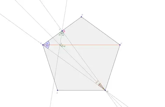

Let us put letters on the pentagon, let it be $ABCDE$, and let $F$ be the mid point of $DE$ as in the picture:
math stackexchange regular pentagon 4352474
Let $I$ be the incenter of $\Delta BEF$, which has the angles with measures $90^\circ=2\cdot 45^\circ$ in $F$, $72^\circ=2\cdot 36^\circ$ in $E$, and $18^\circ=2\cdot 9^\circ$ in $B$.
Then the angle $\widehat{BIC}$ is exterior for $\Delta EIB$, it measures $\hat E+\hat B=36^\circ+9^\circ=45^\circ$, so $I\in CD$ constructed above uniquely matches the point from the problem. So in $\Delta EIF$ $$ \widehat{EIF} = 180^\circ - 36^\circ - 45^\circ = 99^\circ\ . $$
$\square$
