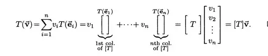

Now I recall how we have derived the fact that linear transformations can be represented as matrix-vector multiplication. Hubbard and Hubbard page 59
(Hubbard and Hubbard page 59, I hope its alright to just insert an image from the book itself) however, see that in the above derivation $v_i$ are just the scalars, (i.e. elements of the coordinate) in the standard basis and thus the tuple formed of $v_i$ on the right (the second last step) is just the coordinate representation of the vector and not the vector itself.
Q2. Does the matrix actually act on the coordinate but not the vector?
