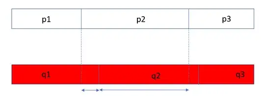

For the moment I have just a visual justification. For example let $n=3$. We can consider a stochastic matrix as a transition probability $T_{ji}=P(X_{n+1}=j|X_{n}=i)$ of a Markov chain, where $i,j=1..3$ are the states. We can than plot next to the other the probability distributions $p,q$ in the following visual way:
, where the total length of the big rectangles is $1$ and the length of the subrectangles are proportional to $p_i$ or $q_i$.
Using such plot we can build a Markov chain that evolves $p$ to $q$. For this purpose to evolve state $i$ we can check the projection of the rectangle associated with $p_i$ onto $q$. For example state 2 will be evolved into state 1 or 2 with a ratio of probabilities proportional to the length of the indicated arrows.
This justifies the fact that we can find stochastic $T$, $R$ such that $Tp=q$ and $Rq=p$ (actually we can find infinite many...). Of course $T,R$ need not be the inverse of the other here we are considering $p,q$ fixed.
