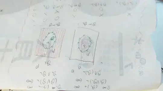

But what is its meaning and venn diagram?
There's a venn diagram by hand.
https://i.sstatic.net/NHfyS.jpg

  • @drhab I just added the venn diagram. You may refer to it. – Stats Cruncher Jan 05 '22 at 09:11

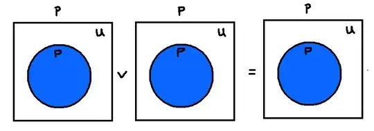

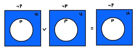

As a venn diagram
A useful rule to keep in mind is that: $P \to Q = \lnot P \lor Q$.
So:
  • $P \to \lnot P = \lnot P \lor \lnot P = \lnot P$
  • $\lnot P \to P = \lnot \lnot P \lor P = P$
As a venn diagram this view also helps since: $\lnot P$ can be seen as "everything that's not in P".
And $\lor$ can be interpreted as combining the two venn-diagrams.
So your statement: $P \to \lnot P = \lnot P \lor \lnot P$, illustrated here: venn diagram for P implies not P
Which you can see at the end just equals $\lnot P$.
For your other one: $\lnot P \to P = \lnot \lnot P \lor P = P \lor P$, illustrated here: venn diagram for not P implies P
Which ends up as just $P$.
(I've written $u$ as the universe in the image out of habit, which you seem to have used $d$ instead, presumably as the domain of discourse which is also correct.)

    @StatsCruncher In case you wonder why noob's Venn diagram differs from mine, theirs is illustrating $\lnot P,$ which is an algebraic simplification of $P{\implies}\lnot P,$ while I am attempting to interpret a direct illustration of $P{\implies}\lnot P.$ – ryang Jan 05 '22 at 12:13

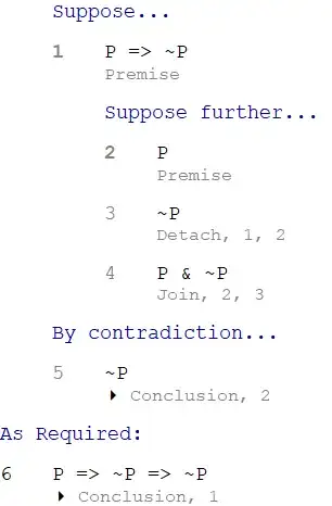

Not sure how useful a Venn diagram would be here, but if $P$ is true implies $P$ is false, then $P$ must be false.
Symbolically: $(P\implies \neg P)\implies \neg P$.

Here is a formal proof by contradiction using a form of natural deduction (screenshot from my proof checker):
