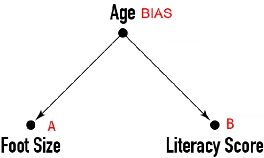

Its much simpler to think of this through Causality.
In the example that you linked to, Age affects both Foot Size and Literary Score. In this coin example, the Bias of the coin affects Toss $A$ and Toss $B$.
The rule here is that after you've drawn out the graph, two events are conditionally independent if you can't traverse from one node to the other without going through a "blocked" node, where a "blocked" node is an event that has has already happened.
Understanding Bayesian Networks will help: http://www.cse.unsw.edu.au/~cs9417ml/Bayes/Pages/Bayesian_Networks_Definition.html
