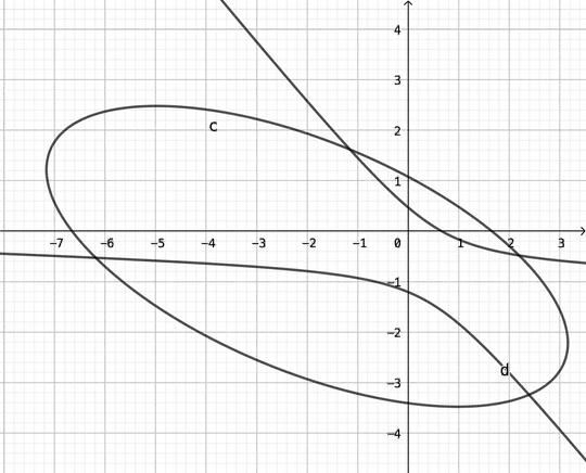

The gröbner basis of the intersection of two conics is generically of the form $\langle p_4(y),cx+q_3(y)\rangle$ (or $\langle p_4'(x),c'y+q_3'(x)\rangle$).
Four intersections of two conics
An example in M2:
R=QQ[x,y,MonomialOrder=>Lex]
I=ideal(x^2+29*x*y+23*y^2+19*x+17*y-13,x^2+2*x*y+3*y^2+5*x+7*y-11)
gens gb I -- matrix {{1507*y^4+3971*y^3-5041*y^2-7358*y-2012, 1318*x+40689*y^3+86119*y^2-179785*y-104956}}
