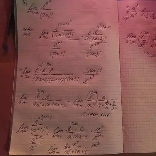

I used the ratio test to calculate this limit, and I got here:
$\lim_{n\to\infty}\frac{e^{2n}}{n^2}\frac{e}{4+6/n+2/n^2}$.

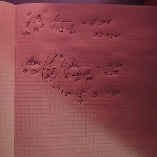

For the first fraction, I applied the ratio test again and got +inf.
I also attach pictures with a more detailed solution. I would like to ask if the procedure and result are correct.

  • I have read through your solution, and it seems fine! You might have heard of the phrase "The exponential $x\mapsto e^x$ grows faster than any polynomial in $x$ for $x\to \infty$". This is another manifestation of this fact. – Stardust9922 Dec 29 '21 at 22:55
    Your calculations look fine, but you should explain how they answer the question. Specifically, your last step says that a particular limit diverges to $\infty$, but that particular limit is not the limit you were asked to evaluate... – Steve Kass Dec 29 '21 at 22:59

  • @Stardust9922 I was confused by the factorial, because it generally grows the fastest. – Aaron7 Dec 29 '21 at 23:05
  • Ratio test doesn't make sense, you are taking a limit not computing the convergence of a series right? – Ninad Munshi Dec 29 '21 at 23:07
  • @NinadMunshi Although you're right that the ratio test is used for series and not limits, there is a similar argument you can make where if $\lim_{x \to \infty} f(x)$ is finite, then $\lim_{x \to \infty} \frac{f(x + 1)}{f(x)} = 1.$ Here that limit doesn't go to $1$ so the limit cannot be finite. I'm not sure if the OP knows this but the argument actually does work out – Stephen Donovan Dec 29 '21 at 23:17
