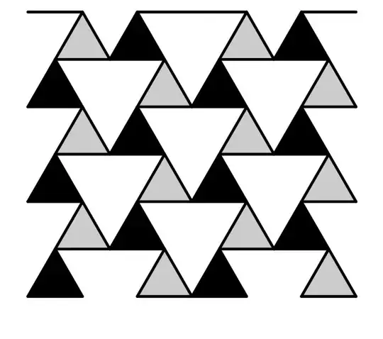

Start by taking the following triangular subdivision of the plane. triangles

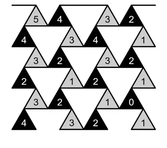

Then, arbitrarily number the smaller triangles with some integer values such that each neighboring pair of triangles' numbers differ by exactly 1. This is one of uncountably infinitely many ways to do this. enter image description here
We next form the 3-dimensional set $$S=\left\{(x,y,z)\in\mathbb{R}^3:\begin{matrix}\text{$(x,y)$ is a vertex of a small triangle}\\\text{and $z$ is that triangle's number}\end{matrix}\right\}$$ So $S$ is a union of vertices of triangles, each projecting onto a small triangle but also vertically displaced by that triangle's corresponding altitude. $S$ should not contain line segments or surfaces, only a few many points are allowed.
We pick some linear transformation $f:\mathbb{R}^3\to\mathbb{R}^2$ such that when represented as a $3\times 2$ matrix, all possible entries of the matrix are algebraically independent over $\mathbb{Q}(S)$ (abuse of notation: we adjoin $\mathbb{Q}$ by all coodinates of points of $S$). In effect this gives a "sufficiently random" projection that maps $S$ back to the 2-dimensional plane. Specifically, the function $f$ bijectively maps between the sets $S$ and $f(S)\subseteq\mathbb{R}^2$ while still being linear.
  • Claim: $f(S)$ divides into two equal parts. This is because $S$ comes in pairs of points $\vec{u},\vec{v}\in S$ sharing the same $x,y$ coordinates, differing only in the $z$ coordinate and by exactly $1$. So we divide $S$ into the bottom points and the top points which differ by a single translation by $(0,0,1)$. And under the linear mapping $f$, $f(S)$ is divided into two parts differing by a single translation by $f(0,0,1)$.
  • Claim: $f(S)$ divides into three equal parts. This is because $S$ also comes in triplets of points $\vec{u},\vec{v},\vec{w}\in S$ sharing the same $z$ coordinate and forming one translate of a small triangle originally in the plane. We similarly divide $S$ by the three possible positions of a vertex from a fixed small triangle, and under the linear map $f$, $f(S)$ is divided into three equal parts that differ by translations in the plane only.
  • Conjecture: $f(S)$ cannot divide into six equal parts. This is where we had to pick $f$ to be sufficiently random when we did so. We also need $S$ to be sufficiently random as well, because otherwise if, for example, all gray triangles receive altitude 0 and all black triangles receive altitude 1, then $S$ partitions into sextuplets that are vertices of triangular prisms. When we made totally random choices whenever we could have done so, I don't see any obvious way how $S$ (and $f(S)$) could be partitioned into six equal parts.
Thus $f(S)$ would be a mock candidate construction for a shape that the OP asked for.
