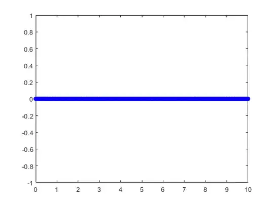

I have the differential equation
$$ \frac{d}{dx}y = 2\sqrt{y} $$
which starts at $x=0$ with $y=0$. Wolfram Alpha says the solution is $y=x^2$.
I can see that when I insert this into the original equation. But I don't understand two things here.
  1. Shouldn't $y=0$ also be a solution? But maybe that is only a Wolfram Alpha issue as it displays only one solution?
  2. I don't understand how $y=x^2$ can "actually happen" in reality. With that I mean using a solver. Because when $y=0$ then also $2\sqrt{y} = 0$ and so $y$ should not ever change at all.
I can confirm this with Matlab:
y0=0;
ode45(@(t,y)(2*sqrt(y)),0:0.01:10,y0);
The code produces:
So this is obviously the $y=0$ solution.
Is the $y=x^2$ some kind of spurious solution that doesn't "exist" in reality? If so how can we know when a solution is "bad"? Or if it does exist how can we get a solver to produce this output?

The point is that $\sqrt{y}$ is not Lipschitz continuous at $0$, so this equation does not satisfy the hypotheses of the Picard-Lindelöf Existence and Uniqueness Theorem for differential equations, and in this case the solution is not uniquely determined by an initial condition.

  • Most likely in the event of this type of singularity where the derivative is zero but the solution doesn't have to be constant, a solver will find the constant solution. But it depends how it's implemented. As for the comment #5 thing, it would depend on more specific subfield information. Generally this sort of thing is related to different types of weak solutions to the same PDE, where one type has non-unique solutions and a "narrower" type has unique solutions. – Ian Dec 28 '21 at 22:41

What happens "in reality" is that ode45 happily follows half-parabola solutions when given an initial condition off the $x$-axis. That means that for almost all initial conditions (i.e., $y(x_0) = y_0 > 0$ for any $x_0 \in \Bbb{R}$), ode45 happily follows a half-parabola solution. But for the special initial conditions on the boundary of these (i.e., $y(x_0) = 0$ for any $x_0 \in \Bbb{R}$), ode45 follows the $y = 0$ solution.
So, if anything, the $y=0$ solution is the weird solution that traps the solver. ode45 should follow the right half of a WA solution if given an initial condition that doesn't trap it in the $y=0$ solution.

  • Wow this is quite a lot to digest, thank you for the detailed answer! For info: I checked the "other" equation $y' = -2\sqrt{y}$ and $y(0)=1$ with ode45. If called without output argument, after reaching $y=0$ it displays the error: Error updating the ODEPLOT window. Solution data may have been corrupted. Argument Y cannot be complex. If called with output as [t,y]=ode45(@(t,y)(-2*sqrt(y)),0:0.01:10,1); it returns a complex solution with negative real part after reaching $y<0$. – user3137490 Jan 02 '22 at 10:19
    @user3137490 : Yup. It overshoots. Exactly hitting zero using a numerical method is ... hard. – Eric Towers Jan 02 '22 at 18:56
