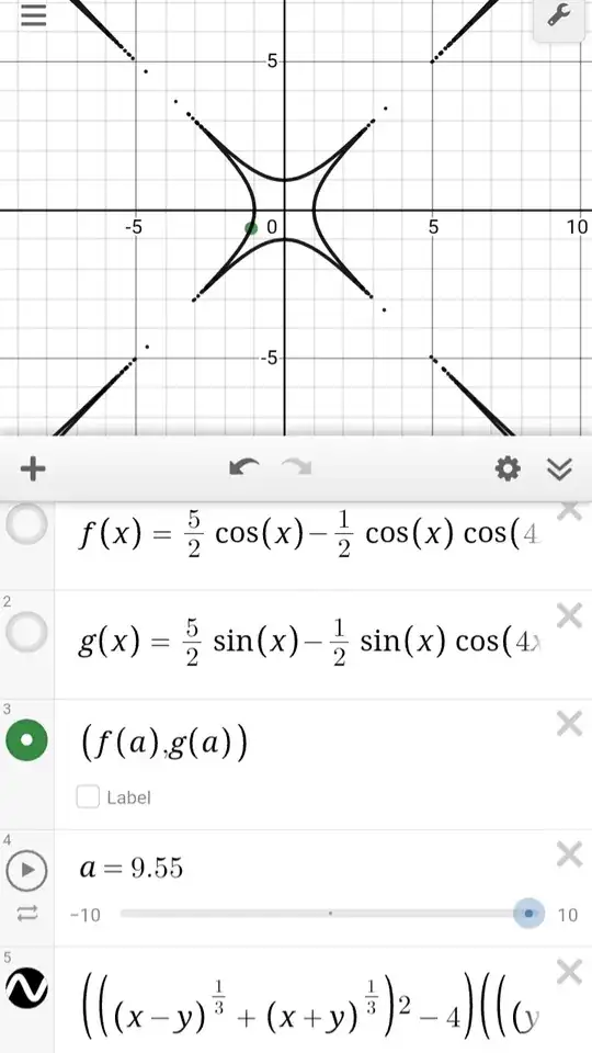

So I first decided to play with geogebra graphing tool.
Solving for $x$ and $y$ we get,
$$x=\frac52\cos\theta-\frac12\cos\theta\cos4\theta-\cos3\theta$$ $$y=\frac52\sin\theta-\frac12\sin\theta\cos4\theta-\sin3\theta$$
The plot looks like this:

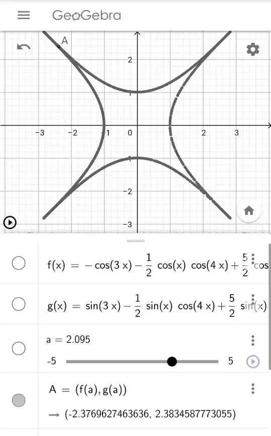

I then tried some other functions and I noted that the locus of point $A$ (in the figure) lies on (approximately),

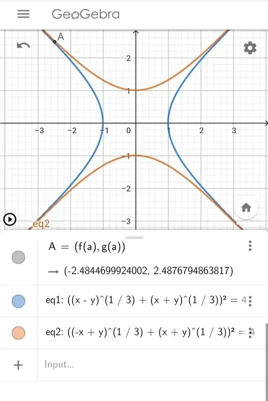

$$\color{blue}{[(x-y)^{1/3}+(x+y)^{1/3}]^2=4}$$ $$\color{#F80}{[(y-x)^{1/3}+(x+y)^{1/3}]^2=4}$$
Thus, the curve, $$\left(\left((x-y)^{1/3}+(x+y)^{1/3}\right)^2-4\right)\cdot\left(\left((y-x)^{1/3}+(y+x)^{1/3}\right)^2-4\right)=0$$ seems to be doing a very good job, but the matter is it is not bounded.
With this clue, could you please help me to end this solution?

If you solve the equations for $(x,y)$ and play with some trigonometric identities, there is another (more symmetric but equivalent) parametrization $$x=\frac{1}{4} (10 \cos (t)-5 \cos (3 t)-\cos (5 t))$$ $$y=\frac{1}{4} (10 \sin (t)+5 \sin (3 t)-\sin (5 t))$$
Using the multiple angle formulae, this reduces to $$x=\cos(t)\,(5-4\cos^4(t))$$ $$y=\sin(t)\,(5-4\sin^4(t))$$
This makes $$(x+y)^2=(\cos (t)+\sin (t))^{10} \qquad \text{and} \qquad (x-y)^2=(\cos (t)-\sin (t))^{10}$$
I am sure that, from here, you can finish.
