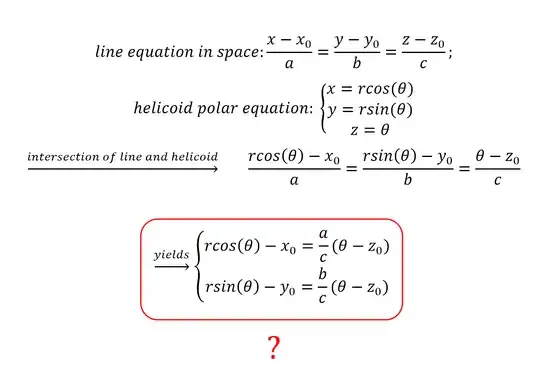

I want to find that the following equation has any analytical solution.
If there is no analytical solution to find $r$ & $θ$ , what numerical method should I use to solve the equation?
this is a research trouble, not class ex. any hint would be highly appreciated.

    Forget about $z=\theta$ for a while, and search for intersection between the line and the cylinder. It will be at most two points, easy to find for the line in parametric form. Then, for both points separately, find $\theta(+2\pi k)$ and test if the equation is satisfied. – A.Γ. Dec 31 '21 at 16:33

I'm sorry to say that I don't know whether analytical solution exists. It exists under some assumptions. It could also be quite easy to solve it numerically.
I'm going to start with the numerical solution as it is what you probably need. One could solve the system numerically as it is given, but the dimension of the problem can be easily reduced. That can be done by using multiplying the equations by $\sin(\theta)$ and $-\cos(\theta)$ respectively and adding them together which gives an equation of a single variable ($\theta$): $$\left[ \frac{a}{c}(\theta-z_0)+x_0\right]\sin(\theta)=\left[ \frac{b}{c}(\theta-z_0)+y_0\right]\cos(\theta) $$ This equation can already be solved numerically pretty easily by Newton's method for example.
It can also be rearanged to this form: $$\tan(\theta)=\frac{a(\theta-z_0)+cx_0}{b(\theta-z_0)+cy_0}= \frac{a\theta-az_0+cx_0}{b\theta-bz_0+cy_0}$$ This form can be used for numerical evaluation aswell though I doubt there is much advantage in terms of efficiency. But from this form it is clear we want to find the intersections of tangentoid and hyperbola. This can be used for graphical solution. It may also be used for spotting important roots, which can then be evaluated numerically.
It may also be of importance to you, that for a larger $|\theta|$ the solutions are closer to a solution of: $$\tan(\theta)\approx\frac{a}{b} \iff \theta\approx\arctan\left(\frac{a}{b}\right)+k\pi$$ It is easy to show: $$\lim_{\theta\to\infty}\frac{a\theta-az_0+cx_0}{b\theta-bz_0+cy_0}=\frac{a}{b}$$ This is nice because for any finite precision needed there is only finite number of solutions which need be solved numerically and the rest of large enough $|\theta|$ is given by this simple equation.
Finally this problem has analytical solution at least for the case the line goes through the origin. Then the aproximate expression above holds exactly: $$\tan(\theta)=\frac{a}{b} \iff \theta=\arctan\left(\frac{a}{b}\right)+k\pi$$

Strating from @Lukáš J.'s answer, consider the function
$$f(\theta)=\left(\frac ac(\theta -z)+x\right)\sin (\theta )-\left(\frac bc(\theta -z)+y\right)\cos (\theta )$$ for which you want the first zero.
For easier manipulations, let $$\alpha=\frac ac \qquad \beta=x-\frac acz\qquad \gamma=\frac bc \qquad \delta=y-\frac bcz$$ to write $$f(\theta)=(\alpha\, \theta+\beta)\sin (\theta )-(\gamma\, \theta+\delta)\cos (\theta )$$
Assuming that $\theta$ could be small, expand $f(\theta)$ as a series around $\theta=0$. This will give $$f(\theta)=-\delta + (\beta -\gamma )\theta +\frac{2 \alpha +\delta }{2} \theta ^2 +\frac{3 \gamma -\beta}{6} \theta ^3 -\frac{4 \alpha +\delta}{24} \theta ^4 +\frac{\beta -5 \gamma}{120} \theta ^5 +O\left(\theta ^6\right)$$ Now, using series reversion, the approximation
$$\theta =t-\frac{2 \alpha +\delta }{2(\beta - \gamma) }t^2+\frac{3 (2 \alpha +\delta )^2+(\beta -3 \gamma ) (\beta -\gamma )}{6 (\beta -\gamma )^2}t^3+\cdots +O\left(t^6\right)$$ where $t=\frac{f(\theta)+\delta }{\beta -\gamma }$; since we want $f(\theta)=0$, then $t=\frac{\delta }{\beta -\gamma }$
I prefer to add a second answer since the approach is totally different.
$$f(\theta)=(\alpha\, \theta+\beta)\sin (\theta )-(\gamma\, \theta+\delta)\cos (\theta )=0$$ can rewrite (@Lukáš J. also did it) $$\tan(\theta )=\frac{\gamma\, \theta+\delta } {\alpha\, \theta+\beta }$$
Downgrading a previous approximation, for $0\le \theta \le \frac \pi 2$ we can write $$\tan(\theta)\sim \frac{x \left(\left(\pi ^2-12\right) x+6 \pi \right)}{(\pi -2 x) (\pi x+6)}$$ and the approximate solution will be given by the solution of the cubic equation $$A\, \theta^3+B \,\theta^2+ C\,\theta+D=0$$ where $$A=2 \pi \gamma -\left(12-\pi ^2\right) \alpha \qquad \qquad B=2 \pi (3 \alpha +\delta )+\left(12-\pi ^2\right) (\gamma -\beta )$$ $$C=6 \pi (\beta -\gamma )+\left(12-\pi ^2\right) \delta\qquad \qquad D=-6 \pi \delta$$
The final equations w.r.t. $r,\theta$ you wrote, do not typically lead to a general closed form answer. We then need to exploit numerical methods: $$ r\cos\theta -x_0=\frac{a}{c}(\theta-z_0) \\ r\sin\theta -y_0=\frac{b}{c}(\theta-z_0) $$ hence $${ r=\sqrt{x_0^2+y_0^2+\frac{a^2+b^2}{c^2}(\theta-z_0)^2+\frac{2ax_0+2by_0}{c}(\theta-z_0)} \\ \cos \theta=\frac{x_0+\frac{a}{c}(\theta-z_0)}{\sqrt{x_0^2+y_0^2+\frac{a^2+b^2}{c^2}(\theta-z_0)^2+\frac{2ax_0+2by_0}{c}(\theta-z_0)}} } $$ So, decoupling $r$ and $\theta$ and treating $\theta$ as the independent variable is the best we can do. Also a simple numerical method on $\theta$ can finish the job.
