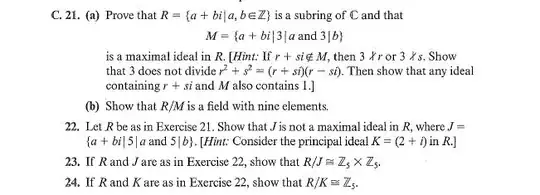

enter image description here I have a quick question about the allowed function use to show isomorphism between quotient rings. The question assumes the following exercise:
Let $R=\{a+bi|a,b\in \mathbb{Z}\}$, and $J=\{a+bi| 5|a, 5|b\}.$ Show that $J$ is not a maximal ideal in $R$ (Hint: Consider the principal ideal $K=\{a+bi\}$ in $R$)
The question asks: If $R$ and $J$ are as in Exercise 1, show that $R/J \cong \mathbb{Z_{5}}$
I know that we can define $\psi: R\rightarrow \mathbb{Z_{5}}$ by $\psi(a+bi)=[a-2b]_{5}$, but can I use the function $\psi(a+bi)=[a+2b]_{5}$ instead?
Note: it is question 24 in the attached picture which assumes notations from exercises 21(a) and 22.

The text doesn't match the screenshot. You're required to prove that if $K=(2+i)$, then $R/K$ is isomorphic to $\mathbb{Z}_5$.
One way is to consider the map $\psi\colon R\to\mathbb{Z}_5$ defined by $\psi(a+bi)=[a-2b]_5$.
Is this a ring homomorphism? One could check this via the definition, but there's a better way. We can consider $\varphi\colon\mathbb{Z}[x]\to\mathbb{Z}_5$ defined by $\varphi(x)=[-2]_5$.
Now we can see that the kernel of this homomorphism contains the ideal $I$ generated by $x^2+1$, because $\varphi(x^2+1)=[-2]_5^2+[1]_5=[0]_5$. Hence this homomorphism induces a ring homomorphism $\psi\mathbb{Z}/I\to\mathbb{Z}_5$ and $\psi(x+I)=[-2]_5$. Now we can “canonically” identify $R$ with $\mathbb{Z}[x]/I$ and we're done, because $$ \psi(a+bi)=\psi(a)+\psi(b)\psi(i)=[a]_5+[b]_5[-2]_5=[a-2b]_5 $$
Can you do the same by mapping $x$ to $[2]_5$? Yes, why not? Repeat the argument and you're done.
Or consider that conjugation is an automorphism of $R$ and if $\psi'(a+bi)=[a+2b]_5$, then $$ \psi'(a+bi)=\psi(\overline{a+bi}) $$ so $\psi'=\psi\circ j$, where $j$ is conjugation.

  • sorry I checked and fixed the typing to align with the screenshot. THe solution from the text reads as follows:
    "As in Exercise 22 define $\psi:R\rightarrow \mathbb{Z_{5}}$ by $\psi(a+bi)=[a-bi]{5}$. The work done there already implies that $\psi$ is a surjective homomorphism. If $a+bi$ is in the kernel then $[a-bi]{5}=[0]_{5}$, so that $a=2b+bq$ for some $q\in \mathbb{Z}$. Therefore $a+bi=(2+i)b+5q=(2+i)\cdot(b+(2-i)q)$ lies in the ideal $(2+i)$. Consequently the kernel is $(2+i)$ and the first isomorphism theorem can be applied."
