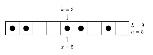

There is a trivial discrete analog. Imagine $L$ boxes in a linearly-ordered row, with $n$ balls in the boxes, such that there are no more than 1 ball in each of the boxes. The probability for the $k$th ball (reading left-to-right) to be in box $x$ is $\binom{x-1}{k-1} \binom{L-x}{n-k}/\binom{L}{n}$ for each possible choice of $x$. (Note that, summing over $x$, this generalizes the ``hockeystick identity'' for binomial coefficients in a trivial way.) This is not quite the same: here the primary interpretation is in terms of the $k$th order-statistics.
