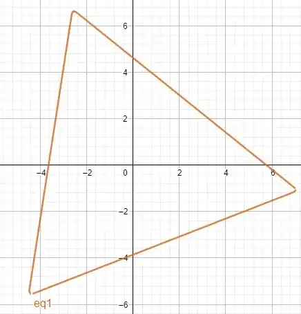

Here is a particular case with $n=3, p=3.5, r=-1.2$:
Proof: Expression (1) is due to a generalization of Viviani theorem expressing the fact that the sum of distances $d_k$ from any interior point of a regular polygon to its sides is a certain constant. See for example here.

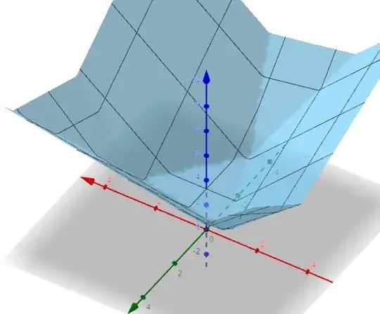

It is interesting to consider the surface with equation
$$z=f(x,y)=\sum_{k=1}^n \ |x \cos(r+ka)+y \sin(r+ka)-p|\tag{2}$$
Please note the difference between (1) and (2): the LHS is no longer restricted to value $np$.
The structure of this surface shows that $z=np$ is a limit case corresponding to a filled triangle, and as soon as we are on a "level set" $np+\varepsilon$, we have a triangle reduced to its sides ; a triangle ? Not really. A triangle with "chamfered" vertices... a phenomena that takes more and more importance as $z$ increases...
