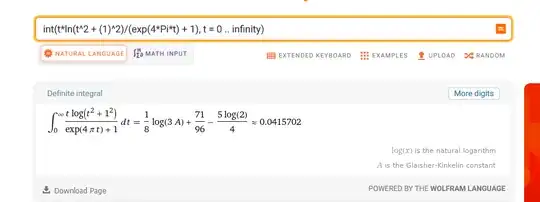

enter image description hereI have the general formulas about:
$$\begin{align} \int_{0}^{\infty}\!{\frac {t\ln \left( {t}^{2}+{z}^{2} \right) }{{ {\rm e}^{\pi\,t}}+1}}\,{\rm d}t &= -4\,\ln \left( \Gamma (z/2 ) \right) -4\,{\it ln}\,G (z/2) +2\,\ln \left( \Gamma \left( z \right) \right)+{\frac{1}{6}}-2\,\ln \left( A \right) \\ &\hphantom{{}={}} + {\frac { \left( -6\,{z}^{2}+4 \right) \ln \left( 2 \right) }{12}}-{\frac {{z}^{2}\ln \left( z \right) }{2}}+{\frac {3\,{z}^{2}}{4}}+2\,{\it ln}\,G \left( z \right)\end{align}$$
And $$\begin{align} \int_{0}^{\infty }\!{\frac {t\ln \left( {t}^{2}+{z}^{2} \right) }{{ {\rm e}^{2\,\pi\,t}}+1}} \, {\rm d}t &= -{\frac {{z}^{2}\ln \left( z \right) }{2}}-\ln \left( 2 \right) {z}^ {2}-{\it ln}\,G \left( z \right) +{\frac {{\it ln}\,G \left( 2\,z \right) }{2}} \\ &\hphantom{{}={}}+{\frac {3\,{z}^{2}}{4}}-\ln \left( \Gamma \left( z \right) \right) +{\frac{1}{24}}-{\frac {\ln \left( A \right) }{2}}+ {\frac {\ln \left( \Gamma \left( 2\,z \right) \right) }{2}}+{\frac { \ln \left( 2 \right) }{24}}\end{align}$$
Where G(z) is the Barnes G-function and A is the Glaisher-Kinkelin constant.
I am interested about the general integral: $$\int_{0}^{\infty }\!{\frac {t\ln \left( {t}^{2}+{z}^{2} \right) }{{ {\rm e}^{4\,\pi\,t}}+1}}\,{\rm d}t$$
I find for example $$\int_{0}^{\infty }\!{\frac {t\ln \left( {t}^{2}+1 \right) }{{{\rm e}^ {4\,\pi\,t}}+1}}\,{\rm d}t = -{\frac {\ln \left( A \right) }{8}}+{\frac{73}{96}}-{\frac {5\,\ln \left( 2 \right) }{4}}+{\frac {\ln \left( 3 \right) }{8}}$$
But be careful, Wolfram give a false closed form.
Please, can someone prove it ?
