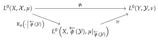

  1. Let us consider the category of systems (or the standard probability spaces, resp.), with the arrows equivariant measurable measure-preserving maps (or arrows measurable measure-preserving maps, resp.). For readability let us suppress everything but the space (= point set = largest element of the associated $\sigma$-algebra = spatial model) and the associated measure, unless it is necessary to be explicit. Let us also denote by $L^0$ the space of real-valued measurable functions identified a.e. according to the prescribed measure. If $\phi: (X,\mu)\to (Y,\nu)$ is an arrow, on function spaces we have two maps: one is the categorical pullback ( = Koopman operator) $\overleftarrow{\phi}: L^0(Y,\nu)\to L^0(X,\mu)$. The other is the conditional expectation $\phi_!: L^0(X,\mu)\to L^0(Y,\nu)$. More explicitly $\phi: (X,\mu)\to (Y,\nu)$ determines a sub-$\sigma$-algebra $\overleftarrow{\phi}(\mathcal{Y})\leq \mathcal{X}$, which in turn determines a conditional expectation operator $\mathbb{E}_\mu\left(\cdot\,\left|\, \overleftarrow{\phi}(\mathcal{Y})\right.\right): L^0(X,\mathcal{X},\mu)\to L^0\left(X,\overleftarrow{\phi}(\mathcal{Y}),\left.\mu\right\vert_{\overleftarrow{\phi}(\mathcal{Y})}\right)$. Then the following diagram defines $\phi_!$ unambiguously:
    enter preformatted text here
What is more, $\phi_!$ is the left inverse to $\overleftarrow{\phi}$, i.e. $\phi_!\circ \overleftarrow{\phi}=\operatorname{id}_{L^0(Y,\nu)}$.

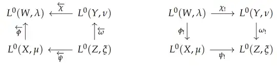

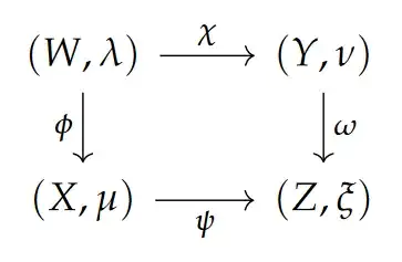

Next let us consider an anonymous square in the category of systems (or in the category of standard probability spaces):
Applying the pullbacks and conditional expectations we get the following squares:

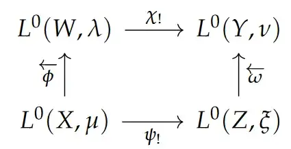

To go from $L^0(X,\mu)$ to $L^0(Y,\nu)$ we can use pullbacks and conditional expectations in tandem, and indeed, Glasner's $P_\lambda$ is exactly (the $L^2$ analog of) $\chi_!\circ \overleftarrow{\phi}$, and the statement that $P_\lambda=P_Z$ is exactly (the $L^2$ analog of) $\chi_!\circ \overleftarrow{\phi}=\overleftarrow{\omega}\circ \psi_!$, that is, as a diagram,

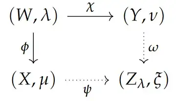

The common factor defined by a joining construction mentioned in the previous section says that if in an anonymous square the bottom right corner is missing it can be filled in:

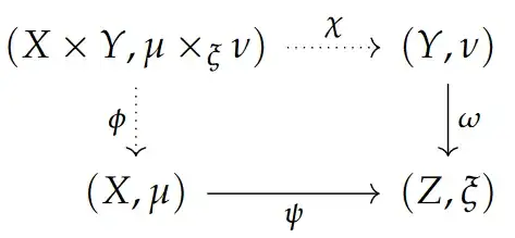

Likewise, the relatively independent joining construction you mention says that if in an anonymous square the top left corner is missing it can be filled in:
Further, in this case by Exr.6.7.1 on p.129 we'll have that $(Z,\xi)\cong (Z_{\mu\times_\xi \nu},\xi_{\mu\times_\xi \nu})$, i.e. up to isomorphism $(Z,\xi)$ is the common factor of $(X,\mu)$ and $(Y,\nu)$ determined by the relatively independent joining $\mu\times_\xi \nu$.

Theorem: Consider an anonymous square in the category of systems:
Then $(W,\lambda)\cong (X\times Y, \mu\times_\xi \nu)$ and $(Z,\xi)\cong (Z_\lambda,\xi_\lambda)$ iff $\chi_!\circ \overleftarrow{\phi}=\overleftarrow{\omega}\circ \psi_!$.

Proof of necessity: To show necessity assume $\lambda=\mu\times_\xi \nu$ and fix an $f\in L^0(X,\mu)$. We claim that $\chi_!\circ \overleftarrow{\phi}(f)=_\nu\overleftarrow{\omega}\circ \psi_!(f)$. At a typical $y\in Y$, starting from the LHS we have:
\begin{align*} \chi_!\circ \overleftarrow{\phi}(f)(y) &=\int_{W} f\circ \phi(w) \,d(\mu\times_\xi \nu)_y(w) =\int_X f(x)\, d\mu_{\omega(y)}(x)\\ &=\psi_!(f)\circ \omega(y) =\overleftarrow{\omega}\circ \psi_!(f)(y). \end{align*}
Here the commutativity of the diagram is used in the second equality.
