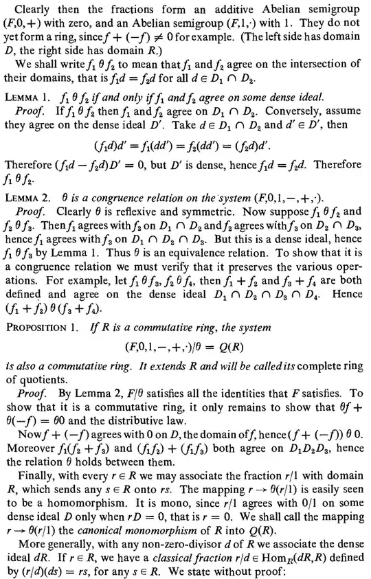

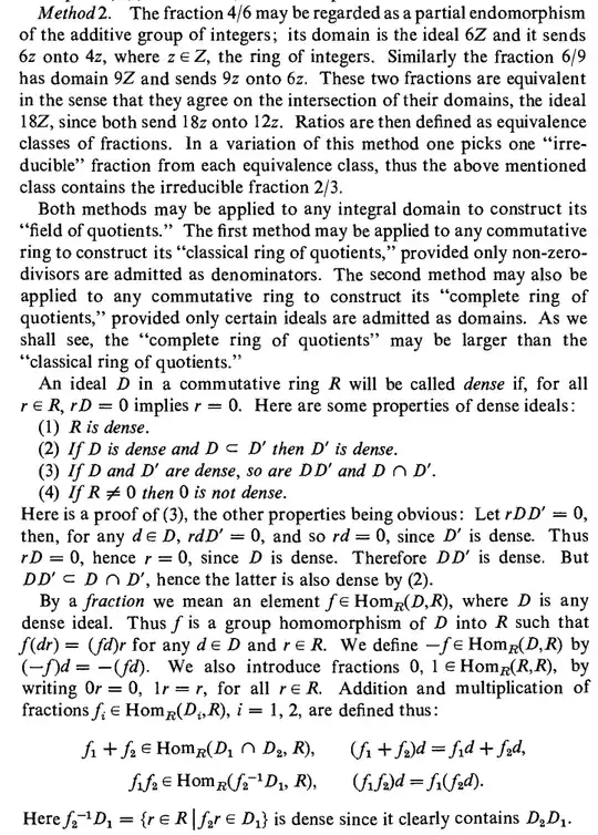

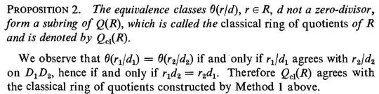

Another approach - not as well-known - is via partial endomorphisms - see below, excerpted from Lambek's book Lectures on Rings and Modules.
enter image description here enter image description here enter image description here
