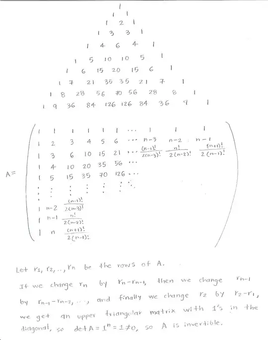

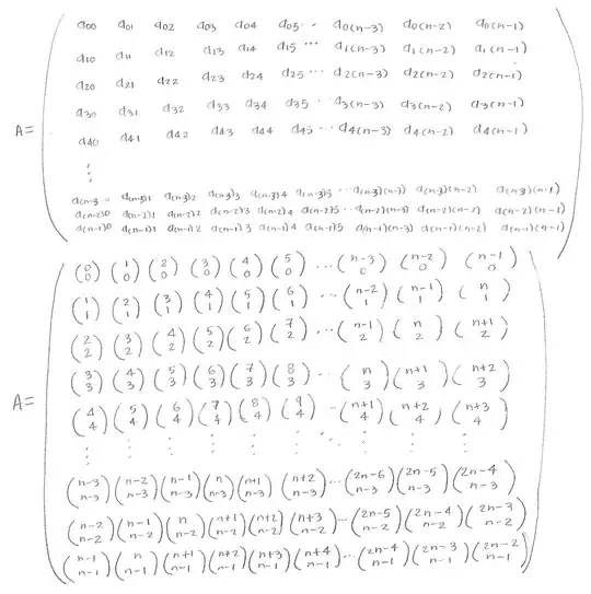

Let $n$ a natural number and $A=(a_{ij})$, where $a_{ij}=\left(\begin{array}{c}i+j \\i\end{array} \right)$, for $0≤i,j<n$. Prove that A has an inverse matrix and that all the entries of $A^{−1}$ are integers.
I tried to prove this like this: (but I'm not sure if it's correct or formal enough)

Also if you could give me a hint to prove the second aasertion it would be great. Thank you.
    Neat handwriting! +1 for showing your work (I don't blame you for not wanting to typeset that monster!) – amWhy Jun 30 '13 at 01:17
  • The second assertion is pretty straight-forward, given that you already have $\det A = 1$. If you are still unsure why, let's take a quick look at the formula for calculating inverse matrix. :) – user49685 Jun 30 '13 at 12:37
