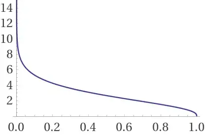

Here is a plot of our goal goal inverse function:
$$Q^{-1}(3,x):$$ enter image description here
