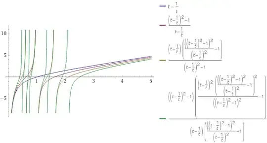

Plot f[k], k=1, 2, 3
Therefore, $\,f_k(x)\,$ has negative infinity gaps in the poles and increasing pieces with $\,f'_k(x)>1\,$ between the poles.
If to consider the equation $\;x_{n+1}=f_k(x_n)\;$ as the simple iteration, then there are not such neighborhood of $\,x=3\,$ which can be compressed via the iteration. I.e. sufficient condition of the simple iteration convergency is not satisfied in the neighborhoods of $\;x=3.$

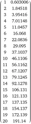

Modeling the first step via the ODE $$\dfrac{\text dx}{\text dt}=-\dfrac1x,\quad x(0)=M_k,\tag2$$ one can get $\;x=\sqrt{M^2_k-2t},\quad t_k =\dfrac12(M_k^2-1)\;\text{iterations},\;$ and with 2 additonal iterations per step we have $$N_s(M)=\dfrac12(M^2+3).\tag3$$
The average quantity of iterations in the step with $\;M_k<M,\;m_k>|g_-(M)|=\frac1{g_+(M)}\;$ equals to $$\bar N_s=\dfrac {g_+(M)}{2(g_+(M)+1)}\int\limits_{\frac1{g_+(M)}}^1 \left(\left(\dfrac1m-m\right)^2+3\right)\,\text dm =\dfrac {g_+(M)}{2(g_+(M)+1)}\left(-\dfrac1m+m+\dfrac13m^3\right)\bigg|_{\frac1{g_+(M)}}^1$$ $$ =\dfrac {g_+(M)\,m}{6(g_+(M)+1)}\left(-\dfrac4{m^2}+1+\left(\dfrac1m-m\right)^2\right)\bigg|_{\frac1{g_+(M)}}^1 =\dfrac {4g^2_+(M)-3g_+(M)-1-M^2}{6(g_+(M)+1)},$$ $$\bar N_s(M) =\dfrac{2M^2-3M+6+(4M-3)\sqrt{4+M^2}}{12(g_+(M)+1)}. \tag4$$ Assuming the average quantity of the required steps before $M_k>M$ to $\;g_+(M)+1\;$ gives $$\bar N_\Sigma(M)\approx\dfrac{2M^2-3M+6+(4M-3)\sqrt{4+M^2}}{12}\tag5$$ iterations totally.
The table of N(M).
