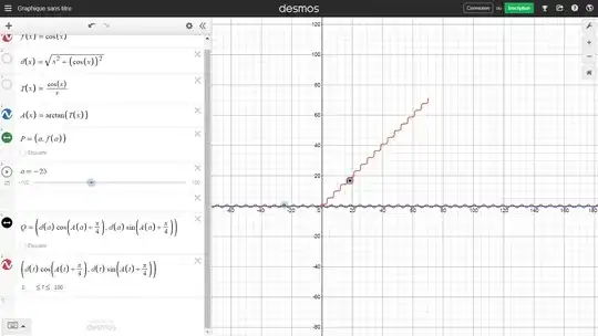

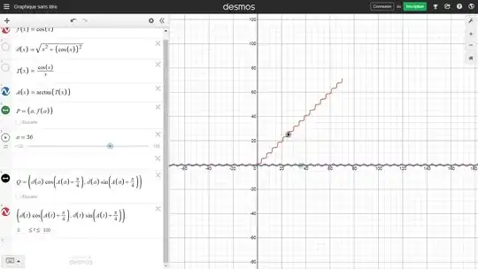

However, this parametric equation produces the desired result only for positive values of $t$ ( or of $x$).
Probably some feature of the $\tan(x)$ function could explain this, but I cannot identify which one it is.
here : a link to my attenpt using Desmos https://www.desmos.com/calculator/mjj6mnr55t
Below, an image for $x\gt 0$
Here , an image of what happens when $x\lt 0$ , point P is in green , its "image " under the parametric function is in dark grey.
