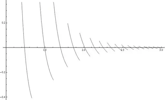

I just want to give you a bigger picture on this question. The fact you point out corresponds to $f(2)>0.$
$f(\text{x$\_$})\text{:=}\left(t=\lfloor \exp (x)\rfloor ;a=t^{1/x};b=(t+1)^{1/x};a^b-b^a\right);$
$\text{Plot}[f(x),\{x,1,3\}]$
