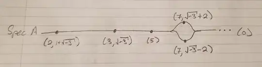

First, what are the (nonzero) primes in $A$? Well, if we write $A = \frac{\mathbb{Z}[x]}{x^2 + 3}$, then we see the prime ideals in $A$ are exactly the prime ideals in $\mathbb{Z}[x]$ that contain $x^2 + 3$. We know that these look like $(p,f)$ where $f$ is irreducible mod $p$, and so we're looking for ideals $(p,f)$ where $f \mid x^2 + 3$ (mod $p$). Of course, we'll write this polynomial $f$ as $f(\sqrt{-3})$ instead of $f(x)$ (since $x = \sqrt{-3}$ in our ring).
For example, let's compute the primes that lie over $(2) \in \mathbb{Z}$. That is, the primes where $p = 2$.
We want to know that
$$ \frac{A}{\left (2,f \left (\sqrt{-3} \right) \right )} \cong \frac{\mathbb{Z}[x]}{(x^2+3,2,f)} \cong \frac{\mathbb{F}_2[x]}{(x^2 + 1, f)} $$
is a field. Of course, the only way to do this is to choose $f = x+1$, which gives us the prime $\left ( 2, \sqrt{-3}+1 \right)$.
Doing this for a few other primes, we can draw a quick picture of $\text{Spec}(A)$:
a picture of spec(A)
(If it's not clear why this is the spectrum, you should work these out in a way analogous to the example for $p=2$ above!)

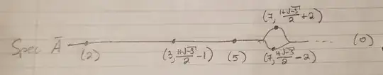

Now, let's take a look at $\overline{A} = \frac{\mathbb{Z}[y]}{y^2 - y + 1}$. Again, elements of the spectrum will look like $(p,f)$ where $f$ is irreducible mod $p$, but now we want $f \mid y^2 - y + 1$ (mod $p$).
Again, let's look at the case $p=2$. Then we want
$$ \frac{\mathbb{Z}[y]}{(y^2 - y + 1, 2, f)} \cong \frac{\mathbb{F}_2[y]}{(y^2 + y + 1, f)} $$
to be a field. Of course, we know that $y^2 + y + 1$ is $\mathbb{F}_2$-irreducible, so $f = y^2 + y + 1$ is our only choice, and we see our prime ideal is just $(2)$ (notice we don't get $(2,f)$, because we already quotiented by $f$ in the passage from $\mathbb{Z}[y]$ to $\overline{A} = \frac{\mathbb{Z}[y]}{f}$!).
spec(Abar)
Notice the spectrum for $\overline{A}$ looks superficially similar to the spectrum of $A$ above every prime except $(2)$. We haven't worked out anything to do with the map $\text{Spec}(\overline{A}) \to \text{Spec}(A)$, but now we might have an intuitive plan for what we should look for algebraically!

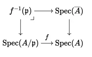

All that's left is to consider what happens over $(2)$. Now, as has been mentioned a few times now, we could handle this case via fibre products. The idea here is that we can find the fibre over $\mathfrak{p}$ by considering the pullback (you should convince yourself of this):
a pullback

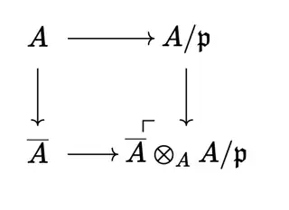

Of course, since the category of affine schemes is dual to the category of rings, we get a pushout of rings:
a pushout
This tells us that $f^{-1}(\mathfrak{p})$ should be $\text{Spec} \left (\overline{A} \otimes_A A/\mathfrak{p} \right )$, which is exactly what the comments and the other answer suggest.
