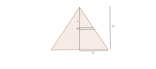

I considered the following section of a cone of height $H$ and radius $R$.
Now, at a height $h$ from the apex of the cone, I considered an infinitesimally small increase in height $dh$. Now, the small increase in volume $dV$ due to the small increase in height $dh$ is given by the volume of the cylinder with height $dh$ and radius r (Note that only half the cylinder is shown in the figure). So,
$dV = \pi{r}^2dh$
Also, due to similarity of triangles, $\frac{r}{h} = \frac{R}{H} \implies r = h\frac{R}{H} \implies r^2 = h^2\frac{R^2}{H^2}$

The problem is while trying to derive an expression for the curved surface area using the same method. Here, if I consider the small change in area to be the curved surface area of the infinitesimally thin cylinder and integrate from $0$ to $H$, this happens:
$$dA = 2\pi rdh$$ $$A = \int_0^H 2\pi rdh$$ $$A = 2\pi\int_0^H h\frac{R}{H}dh$$ $$A = 2\pi\frac{R}{H}\int_0^Hhdh$$ $$A = \pi RH$$
However, this is the wrong expression and the required area is actually $A = \pi R S$, where $S$ is the slant height of the cone.

This is perhaps easier to see when trying to get the length of an oblique line using the same approximation technique: as a sum of lengths of horizontal pieces. Even now, you should already see that this can't work.
Let $y = mx+y_0$ be a line of interest and suppose that we wish to know the length of the line on the interval $[a,b]$. We choose an integer $N > 0$ and partition $[a,b]$ into $a = x_0 < x_1 < x_2 < \cdots < x_{N-1} < x_N = b$. In each interval, we approximate the length of the line in that interval by the width of the interval. That is, for the interval $[x_i, x_{i+1}]$ we approximate the length of the piece of line in that interval by $x_{i+1} - x_i$. Accumulating all the contributions to the length of the line, $$ \sum_{i=0}^{N-1} \left( x_{i+1} - x_i \right) = b-a \text{.} $$ Happily, it is easy to compute the limit as $N \rightarrow \infty$ of this sum, obtaining $b-a$.
Of course, $b-a$ is the correct length only when $m = 0$.
What goes wrong? In short, the difference between the approximate length and the correct length is not decreasing to zero as $N \rightarrow 0$. So this approximation scheme can't work.
You've literally applied the same approximation technique for your cone and you are observing the same failure to approach the correct value in the limit.
The contribution from each slice is larger by a constant factor. For my line, that factor is $\sec(\tan^{-1}(m))$. (The arctangent of $m$ is the angle of elevation and the secant is the ratio of the length of the hypotenuse (the actual chunk of the line) to the adjacent (the width of the interval) at that angle.) If we put in this longer approximation to the length in each element of the partition, we get the correct result.
