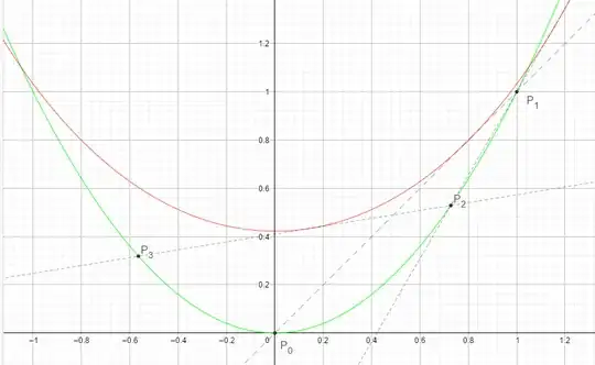

The geometry background of the problem
Let curve $C_0: y=x^2$ and $C_1: 4x^2+y^2-8y+\frac{16}5=0$,
Point $P_0(0,0)$ is in curve $C_0$.
From point $P_0$ we could find two tangent line of $C_1$ and one of them intersect $C_0$ at $P_1(1,1)$.
From point $P_n(a_n, b_n)$, we could find a tangent line of $C_1$ not passing through $P_{n-1}$ which intersect $C_0$ at $P_{n+1}(a_{n+1},b_{n+1})$.

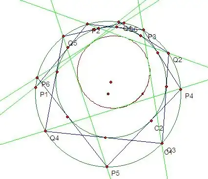

Geometry representation of the sequence As an extension of Poncelet's Theorem, I have found that lines $P_0P_k, P_1P_{k+1},P_2P_{k+2},...,P_hP_{k+h},...$ are all tangent to a conic section $C_{t_k}$ and $C_{t_k}$ passing through the intersection of $C_0$ and $C_1$ so that we could write $C_{t_k} = C_0 + t_k C_1$.
And more general, similar to list $P_0,P_1,P_2,...$, starting from another point $Q_0$ in $C_0$, we could form another list $Q_0, Q_1,Q_2,...$, then lines $P_0Q_0, P_1Q_1,P_2Q_2,...$ are all tangent to a conic section passing through the intersection of $C_0$ and $C_1$.
Two points list tangent another conic section
We could always using a $3\times 3$ matrix to represent a conic section in homogenous coordinates so that $\begin{bmatrix}A&B&C\\B&D&E\\C&E&F\end{bmatrix}$ could be used to represent the curve $Ax^2+2Bxy+Dy^2+2Cx+2Ey+F=0$.
So $C_0=\begin{bmatrix}1&0&0\\0&0&-\frac12\\0&-\frac12&0\end{bmatrix}$ and $C_t=\begin{bmatrix}1+3t&0&0\\0&t&-\frac{1+7t}2\\0&-\frac{1+7t}2&\frac{16t}5\end{bmatrix}$.
$C_t^{-1}=-\frac{1}{181t^2+70t+5}\begin{bmatrix}\frac{-181t^2 - 70t - 5}{3t + 1}&0&0\\0&64t&70t+10\\0&70t+10&20t\end{bmatrix}$
Next, if there're two points $(x_1,x_1^2), (x_2,x_2^2)$ in $C_0$ and the line through them is tangent to $C_t$, we could find that $\begin{pmatrix}-(x_1+x_2)&1&x_1x_2\end{pmatrix}C_t^{-1}\begin{pmatrix}-(x_1+x_2)\\1\\x_1x_2\end{pmatrix}=0$. According to definition of $C_{t_k}$, There're points $(x_1,x_1^2),(x_2,x_2^2),(x_3,x_3^2)$ so that
$\begin{cases}\begin{pmatrix}-(x_1+x_2)&1&x_1x_2\end{pmatrix}C_{t_k}^{-1}\begin{pmatrix}-(x_1+x_2)\\1\\x_1x_2\end{pmatrix}=0\\ \begin{pmatrix}-(x_2+x_3)&1&x_2x_3\end{pmatrix}C_{t_k}^{-1}\begin{pmatrix}-(x_2+x_3)\\1\\x_2x_3\end{pmatrix}=0 \\ \begin{pmatrix}-(x_1+x_3)&1&x_1x_3\end{pmatrix}C_{t_{2k}}^{-1}\begin{pmatrix}-(x_1+x_3)\\1\\x_1x_3\end{pmatrix}=0 \end{cases}$
Let $x_2=0$ we get quadratic equations of $x_1,x_3$ with same coefficients (in parameter $t_k$). By Vieta's formulas, from the first two equations, we have $x_1x_3=-r(t_k)=-\frac{192t_k^2+64t_k}{181t_k^2+70t_k+5}$ and $t_{2k}=\frac{5r(t_k)}{5r(t_k)^2-35r(t_k)+16}$.
Now let $x_1=a_0=0$, and substituted into 3rd equation and we have $a_{2k}^2 = r(t_{2k})$ and similar we have $a_k^2=r(t_k)$ and finally we could get the relationship between $a_k^2$ and $a_{2k}^2$.
Similarly by composite $C_1$ and $C_k$ and applying Vieta's formula, we have $a_{k-1}+a_{k+1}=\frac{8a_k}{-5a_k^2+16}$ to verify the recursive formula in the problem is held for the sequence.
