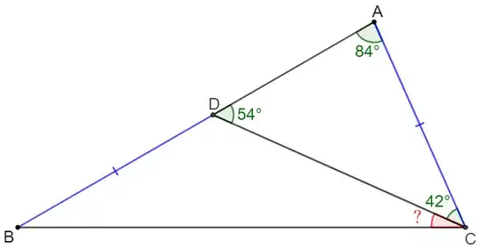

The Figure of Problem
Where $\angle{A}=84^{\circ}, \angle{ACD}=42^{\circ}, BD=AC$, find $\angle{BCD}$.
Wonder if there is solution without using trigonometric functions.
I tried with getting circumcenter of triangle ABC, but seems hard to prove it forms an equilateral triangle with side AC.
Also if trying from equilateral and form an Isosceles triangle with two angles of $24^{\circ}$, and then form another isosceles triangle with top angle to be $\angle{B}=24^{\circ}$, it is not easy to prove that $\angle{ADC}=54^{\circ}$.

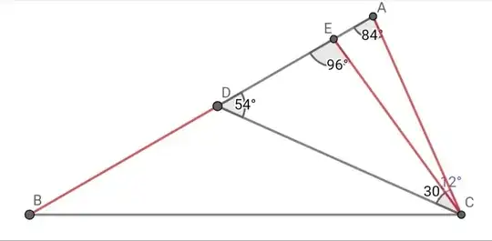

Draw isosceles triangle $ACE$ such that $CA=CE$.
step1

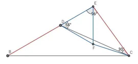

Let the circumcentre of $\triangle DEC$ be $F$ and draw the equilateral triangle $DEF$.
step2
$\angle CEF=\angle ECF=36^\circ$.

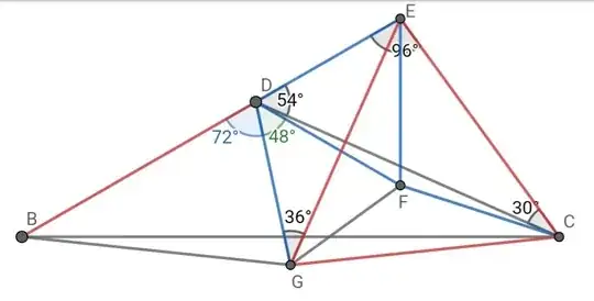

Now construct another equilateral triangle with side $CE$ as in the figure.
step3
$\angle DEG=36^\circ$
$\therefore\triangle DEG\cong\triangle FEC\text{ (S-A-S)}\\ \implies DE=DG.$
Also $\angle BDG=72^\circ.$

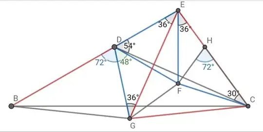

Then mark point $H$ on $CE$ such that $CF=CH$.
step4
$\therefore \angle CHF=\angle CFH=72^\circ$.
Also $\triangle EHF$ is isosceles.
Now we can see $\triangle EDG\sim\triangle EHF$. From there we can prove that $\triangle BGE\sim \triangle CFE$.
From similar isosceles triangles above, $\frac{ED}{EG}=\frac{EH}{EF}.$
Adding $1$ to both sides, $\frac{EB}{EG}=\frac{EC}{EF}\implies\small \triangle BGE\sim \triangle CFE.$
It shows that $BG=GE$ and then we can easily show $\angle EBC=\angle ABC=30^\circ.$

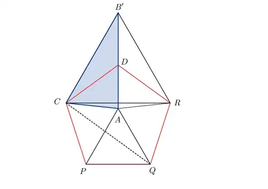

Working "the other way around" sometimes helps. Consider triangle $\triangle ACD$, and construct the regular pentagon $PQRDC$ as shown above, noting that $AD$ bisects $\angle CDR$. Finally produce $AD$ to $B^\prime$ in such a way that $\triangle CRB^\prime$ is equilateral.
We will show that $B \equiv B^\prime$, by proving that $B^\prime D \cong AC$, as in the triangle in OP's hypotheses.
  1. Angle chasing yields $\measuredangle ACP = \measuredangle CAP = 76^\circ$. Thus $\measuredangle CPA = 48^\circ$.
  2. Working similarly on $\triangle ARQ$ allows to claim that $\triangle PAQ$ is equilateral.
  3. Angle chasing and $CQ \cong RB^\prime$ imply that $\triangle B^\prime DR \cong \triangle ACQ$ (SAS), and, in particular $B^\prime D \cong AC$.
So, as stated, $B^\prime\equiv B$, and, in particular $$\boxed{\measuredangle DCB = 24^\circ}.$$
