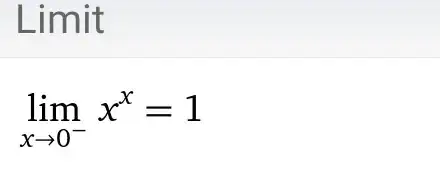

P.S. Here, I also provide what Wolfram Alpha says about the limit:

  • @LouisPan As I said before that we only have limit (two-sided)... Most people believe that the value of the two-sided limit is one (in my Maths group). Actually, I also want to confirm this. – user516076 Nov 03 '21 at 01:42
  • Sorry, I don't understand. You said "I still can't process why $\lim_{x \to 0^-} x^x = 1$"; and I asked where you saw this. This is a "wrong" identity. Or you thought you should have $\lim_{x \to 0} x^x = 1$ and hence the question? –  Nov 03 '21 at 01:45
  • @Henry Still lost sorry. Are you saying the limit isn't 1. Or the left-sided limit doesn't exist? – user516076 Nov 03 '21 at 01:45

In the world of real analysis, the function $f(x)=x^x$ is defined only for positive real numbers. Its domain is $(0,\infty)$. So it does not make sense to write $\lim_{x \to 0^-} x^x$ and $\lim_{x \to 0}f(x)$ does not exist$\dagger$. On the other hand, $$ \lim_{x \to 0^+} x^x = \lim_{x \to 0^+} e^{x\ln x}=1 $$ where we use the definition $x^x:=e^{x\ln(x)}$ for $x>0$.
In complex analysis, one could extend the function for negative values of $x$ (or even complex values in general). What one has then is $$ x^x=e^{x\text{Ln}(x)},\quad x<0 $$ where $\text{Ln}$ takes a branch that contains the negative x-axis.
$\dagger$ Sometimes, people write $\displaystyle\lim_{x\to a;x\in S}f(x)$ where $S\subset\mathbb{R}$ is the domain of $f$ and $a$ is an accumulation point of $S$. When the context is clear, one may write $\lim_{x\to a}f(x)$, omitting $x\in S$. In the above example, if one writes $\lim_{x\to 0}x^x=1$, one really means $\lim_{x\to 0^+}x^x=1$.
