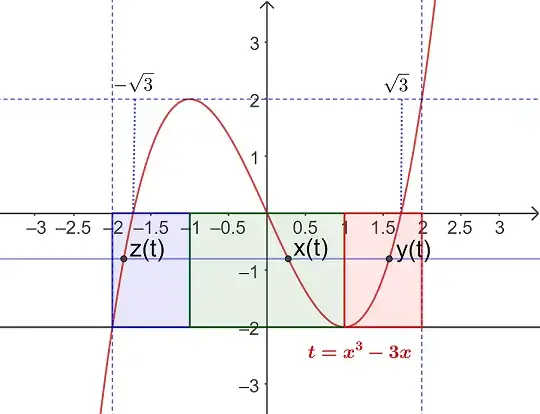

The approach presented by OP is clever and fine. It seems that just one aspect needs to be revised. Instead of $t\in[-1,0]$ we consider $t\in[-2,0]$. The graphic below might be helpful to better see what's going on.
We see the red colored function \begin{align*} &h:[-2,2]\to\mathbb{R}\\ &h(x)=x^3-3x \end{align*} and observe the domain can be split into three intervals \begin{align*} [-2,2]=[-2,-1]\cup[-1,1]\cup[1,2] \end{align*} where the function $h$ has inverse functions denoted with $z=z(t), x=x(t)$ and $y=y(t)$. The rectangular regions of interest are colored in blue, green and red.
We want to show, given $g:[-2,2]\to\mathbb{R}$ an even, continuous function we have \begin{align*} \color{blue}{\int_{0}^{1} g(x^3-3x)\,dx=\int_{1}^{2} g(x^3-3x)\,dx}\tag{1} \end{align*}
In order to show (1) the idea is to use Vieta's formula applied to the zeros $x(t), y(t), z(t)$ of \begin{align*} h(x)-t = x^3-3x-t=0 \qquad\qquad t\in[-2,0]\tag{3} \end{align*} where the sum of the zeros is derived from the coefficient of $x^2$ in $h(x)-t$ which is equal to zero. \begin{align*} x(t)+y(t)+z(t)=0\qquad\qquad t\in[-2,0]\tag{2} \end{align*} When looking at the limits of integration in (1) we see that in $[0,1]\cup[1,2]$ only $x(t)$ and $y(t)$ are involved. But we can use that $g$ is an even function and split the interval $[1,2]=[1,\sqrt{3}]\cup[\sqrt{3},2]$. Since $g$ is even we consider $[-2,-\sqrt{3}]$ instead of $[\sqrt{3},2]$ and bring this way $z(t)$ into play so that (2) can be used conveniently.
We start with the right-hand side of (1) and obtain \begin{align*} \color{blue}{\int_{1}^{2}}&\color{blue}{g(x^3-3x)\,dx}\\ &=\int_{1}^{\sqrt{3}} g(x^3-3x)\,dx+\int_{\sqrt{3}}^{2} g(x^3-3x)\,dx\\ &=\int_{1}^{\sqrt{3}} g(x^3-3x)\,dx+\int_{-2}^{-\sqrt{3}} g(x^3-3x)\,dx\tag{3.1}\\ &=\int_{-2}^{0} g(t)\,dy(t)+\int_{-2}^{0} g(t)\,dz(t)\tag{3.2}\\ &=\int_{-2}^{0} g(t)\left(y^{\prime}(t)+z^{\prime}(t)\right)\,dt\\ &=-\int_{-2}^{0} g(t)x^{\prime}(t)\,dt\tag{3.3}\\ &=-\int_{1}^{0} g(x^3-3x)\,dx\tag{3.4}\\ &\,\,\color{blue}{=\int_{0}^{1} g(x^3-3x)\,dx} \end{align*} and the claim (1) follows
Comment:
  • In (3.1) we use that $g$ is even.
  • In (3.2) we substitute the inverse function $y=y(t)$ and $z=z(t)$.
  • In (3.3) we use (2) and get by differentiation $x^{\prime}(t)+y^{\prime}(t)+z^{\prime}(t)=0$.
  • In (3.4) we substitute back $x^3-3x=t$.
