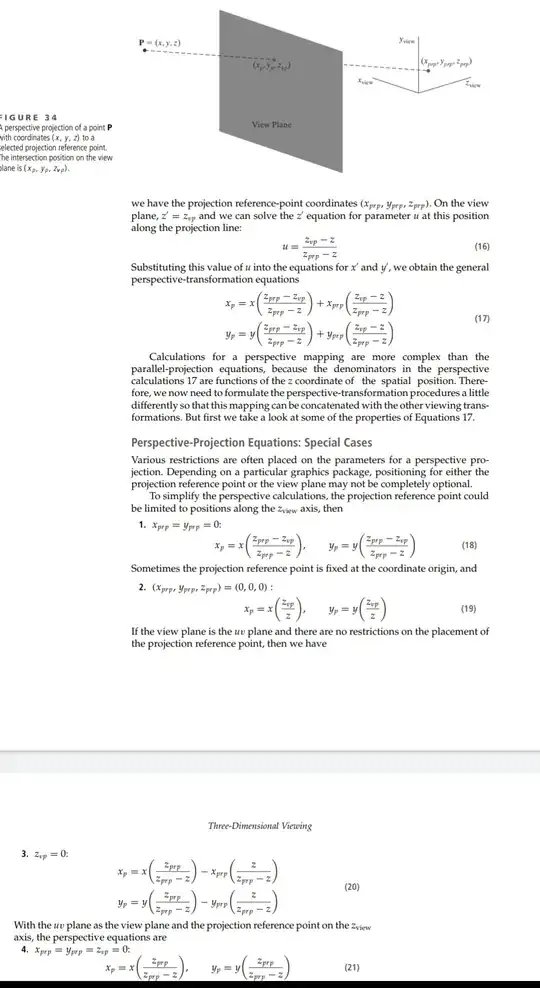

I am reading perspective projection from computer Graphics Hearn Baker book. But two concepts are not understanding. enter image description here
Special cases 3 and 4 not understanding.
Case:3 when $z_{vp}=0$ then projection reference point exists in view plane. So how can I get projection? But some website saying the reference point where all the projectors (projection lines) converge has to have a non-zero coordinate (because you don't get an image if the reference point is in the viewing plane itself). I don't understanding how?
Case:4 It maybe understandable after getting knowledge of case 3.

  • "when $z_{vp}=0$ then projection reference point exists in view plane." That is not what the book says. The projection reference point is at $z_{prp},$ not $z_{vp}.$ I think we are supposed to remember that the projection reference point must not be in the view plane, so the book does not spend precious ink explaining over and over that the projection reference point is not in the view plane in this example, or in that example, or in that example either. – David K Oct 27 '21 at 01:19
  • @David One thing tell when I see image, video, movie on screen by parallel projection? And when I see any 3D movie it's example of perspective projection? Am I correct? – S. M. Oct 27 '21 at 01:26
  • @David could you insert your comments in answer, I will accept your answer.. – S. M. Oct 27 '21 at 01:34
That is not what the book says. The projection reference point is at $z_{prp}$, not $z_{vp}$. I think we are supposed to remember that the projection reference point must not be in the view plane, and therefore when Case 3 says $z_{vp}=0$ we will conclude that of course $z_{prp} \neq 0$ in that case.
I think Figure 34 is supposed to illustrate the general case of the perspective projection as well as all the special cases, but to be honest it is difficult to use one single figure for all cases. Unless the book has additional figures after this excerpt, it seems we are supposed to understand from the figure that although the viewing plane is parallel to the $x_{view}$ and $y_{view}$ axes, as shown in the figure, it might (in the general case or in a special case) be at any distance in front of, behind, or exactly on those axes, not just where it is shown. I think Figure 34 is also meant to say that the projection reference point (in the general case or in a special case) might be anywhere at all -- on an axis, in one of the coordinate planes, not on any axis or coordinate plane, or exactly at the origin, not just in the place somewhere off-axis where it is shown in the figure. So almost all the actual relative placements of objects in the figure might not be how the objects are actually placed. But one relative placement in the figure that must be like the way it is shown in the figure is that the projection reference point is somewhere away from the view plane. So wherever we put the view plane, we must put the projection reference point somewhere else (at a different $z$ value).
