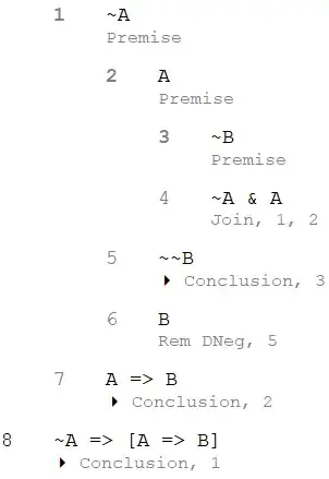

You can prove from "first principles" that $\neg A \implies [A \implies B]$ using a form of natural deduction as follows. (Screenshot from my proof checker)
