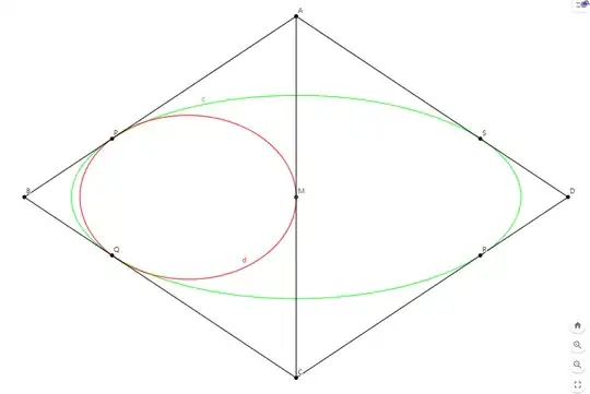

My team is recently working on the expansion of Siebeck-Marden Theorem into parallelograms, and found a conjecture that the ratio of Area(d)/Area(c) is constant. (Picture below : BP : PA = BQ : QC = DS : SA = DR : RC = m : n and M is the midpoint of AC. c is the green ellipse inscribed in ABCD, tangent in P, Q, R, S, and d is the red ellipse inscribed in ABC, tangent in P, Q, M.)

The ratio seems to result in $\frac{2}{3 \sqrt{3}}$ by guess, and we checked for 5 different cases in Geogebra.
$$\text{Ratio} = \frac{\text{Area}(c)}{\text{Area}(d)} \approx 0.39$$
The result is not that correct since we did not construct the ellipse, but drew it by hand(which is an approximation.). The result is still very close to the guess.

  • Two questions : 1) How are defined variables c and d in S(c)/S(d) ? 2) You say "parallelogram" but your figure displays the particular case of a lozenge. Isn't it misleading ? Couldn't you replace this figure by a more general one ? – Jean Marie Oct 21 '21 at 09:45
  • Another well-written AMM text using barycentric coordinates, a key technique I advise you to consider for such questions using ratio of areas. – Jean Marie Oct 21 '21 at 09:54
  • @JeanMarie 1. S is the area function and c and d are ellipses in the picture. (explanation added) 2. I drew a lozenge since it was easier to draw, but I did check other 5 cases in a parallelogram. Will change the picture though. – Vue Oct 21 '21 at 11:44

Let $N$ be the midpoint of $PQ$. Then: $MN:BN=n:m$ and $PN:AM=m:(m+n)$.
We can use the following useful property of ellipses:
If from an external point $B$ a pair of tangents $BP$, $BQ$ are drawn to an ellipse of centre $M$, and line $BM$ intersects $PQ$ in $N$ and the ellipse in $G$, then $N$ is the midpoint of $PQ$ and $MG$ is the mean proportional between $MB$ and $MN$.
This property is easy to prove for a circle, and still holds for an ellipse because a stretching preserves all ratios on the same line.
With this property we can find $MG/MB$, $MH/MA$ and $OE/MB$.
Finally, from ellipse equation $(PN/OF)^2+(ON/OE)^2=1$, we can find $OF/MA$.
The ratio of areas is $(OE\cdot OF)/(MG\cdot MH)$ and, according to the result I got, is not independent of $m/n$.
