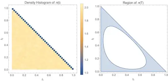

Example. Let $k = 3$ and $T$ be the set of all distributions on $S = \{1,2,3\}$ for which the entropy (in nats) is less than or equal to $\frac{3}{4}\log 3$:
$$T = \biggl\{ (t_1, t_2, t_3) : t_i \geq 0, \ \sum_{i=1}^{3} t_i = 1, \ \text{and} \ \sum_{i=1}^{3} t_i \log(1/t_i) \leq \tfrac{3}{4}\log 3 \biggr\}. $$
  • Using a numerical method, the ratio of the area $\pi(T)$ and the area of $\pi(\operatorname{Dist}(S))$ is estimated as $0.417781$.
  • Using $10^7$ samples from the distribution of $t$ and counting the proportion of samples lying in $T$, the value of $\mathbf{P}(t \in T)$ is estimated as $0.417705 \pm 0.00040$ at a $99\%$ confidence level.
density histogram of samples of t, and region T
