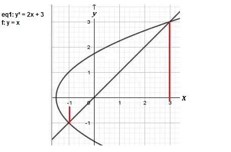

The sign in front of a radical is $\pm$ presents itself with symbolic action detail whether or not intended.
Solution of equations
$$ y=x, \; y^2= 2x + 3\; $$
have two intersections
$$ (-1,-1),(3,3)$$
would present themselves due to association with all connotations of the symbol's action.. represented by the square root radical in this case.
If technically is meant to include comprehensively , yes, it does count as a valid solution.
