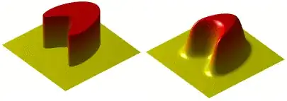

The current Wikipedia article on the heat equation includes a gif which shows how the solution to the heat equation evolves over time if the initial data is the indicator function of a domain.
melt
Suppose $w(t,x)$ is the solution to the heat equation $w_t=\Delta w$ satisfying $w(0,x)=\mathbb{1}_A(x)$ for a nice set $A$. Suppose further that the function $w(t,x)$ (as a function of $x$) attains a unique maximum at $x=a(t)$ for each $t$ in some interval $(0,\varepsilon)$, and we can define the thermal center of $A$ to be the limit $a=\lim\limits_{t\to0^+} a(t)$. (I made up this concept.)
Can this be given an integral formula, or integral characterization? Or some other nice and interesting characterization? For example, maybe it happens to be the center of mass of $A$, or something. Or, what is it for, say, a triangle?
