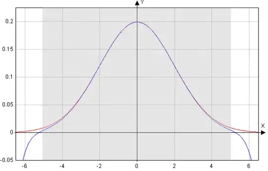

The approximation of the Gaussian curve (red) by the polynomial (blue) looks as follows:
