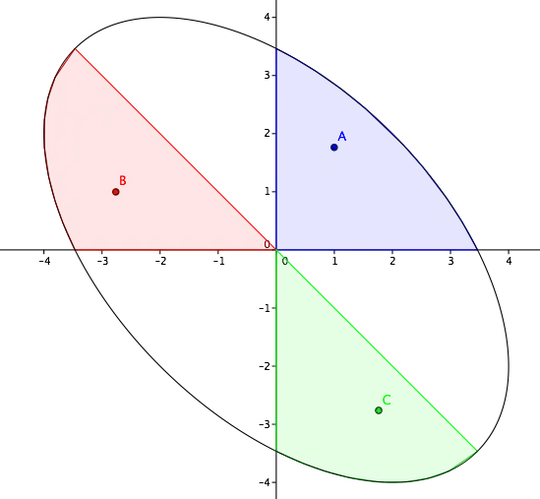

Here's a picture of your ellipse: when point $A=(x,y)$ lies in the first quadrant (blue region), then point $B=(-x-y,x)$ lies in the red region and point $C=(y,-x-y)$ lies in the green region.
Switching the sign of coordinates for $A$ (third quadrant) causes the same to happen for $B$ and $C$. And areas are indeed the same: $$ \text{blue area}=\text{red area}=\text{green area}= \frac{2012 \pi }{3 \sqrt{3}}. $$
That the area is the same can be proved just by noticing that the transformation sending $A$ to $B$ (or to $C$) is a linear mapping with determinant equal to $1$.
