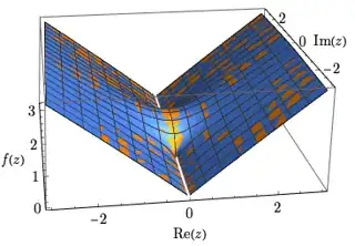

As explained in this answer, we can use a Möbius transformation $$ z\mapsto \frac{z+i}{z-i}, $$ under which the branch cuts are essentially transformed into each other, and define the function $$ g(z)=(z-i)\exp\left(\frac{1}{2}\log\left(\frac{z+i}{z-i}\right)\right), $$ which matches $f(z)$ for $\operatorname{Re}(z)>0$. We can verify this with Mathematica by plotting these functions (below).

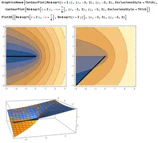

sqrt[z_, s_] := Sqrt[Abs[z]] Exp[I/2 Arg[z Exp[-I (s + π)]] + s + π]
This subtracts a phase from the argument $z$, evaluates the Arg function, and then adds the phase back in. Here's an example where we rotate the branch cut by $\pi/4$ (plotting the real part of the function):

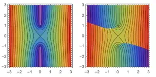

The same trick doesn't work here. First of all, we can define this function via the square root function with the different branch cut in the following way. Define the square root with a rotated branch cut rotated by $\sigma$ as $$ \operatorname{sqrt}(z) = \sqrt{|z|}\exp\left( \frac{i}{2}\left(\operatorname{Arg}(ze^{-i(\sigma+\pi)}) + \sigma + \pi\right) \right). $$ Then, we can just define $$ g(z) = \operatorname{sqrt}(z^2+1) $$ in order to change the branch cut. Unfortunately, this doesn't rotate the branch cut but rather deforms it, as can be seen in the following plot of the real parts of $\sqrt{z^2+1}$ and $g(z)$ with $\sigma=3\pi/4$ (it starts off linear in the vicinity of the branch point, but then curves away):
So instead, I tried to do something similar to what we did with the square root function directly. Basically, since $$ \sqrt{z^2+1} = \sqrt{|z^2+1|}\exp\left(\frac{i}{2}\operatorname{Arg}(z^2+1)\right), $$ it seems like we should be able to redefine the argument directly in such a way that the branch cut becomes linear in some arbitrary direction by doing something like $$ \operatorname{Arg}(z^2+1) = \operatorname{Arg}\left(\left(ze^{-i(\sigma+\pi)}\right)^2+1\right) + (?), $$ but I cannot figure out what $\sigma$ should be.

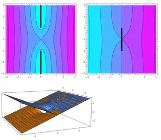

The trick is to play fast and loose with the complex arithmetic of root rules and just factor the function into "linear" factors, i.e., $$ \sqrt{z^2+1} "=" \sqrt{z+i}\sqrt{z-i}. $$ These two expressions are not actually equal under the standard choice of branch cut for the square root, as can be seen by plotting their real parts (the two functions are identical everywhere except where you can see the orange):
The branch cuts have been rotated by $\pi/2$ in opposite directions. In order to rotate the branch cuts arbitrarily, we use the $\operatorname{sqrt}$ function from the OP: $$ \operatorname{sqrt}(z;\sigma) = \sqrt{|z|}\exp\left( \frac{i}{2}\left(\operatorname{Arg}(ze^{-i(\sigma+\pi)}) + \sigma + \pi\right) \right). $$ This allows us to choose the branch cuts for each square root independently. Note that taking $\sigma=-\pi$ gets us the standard choice for the branch cut of $\sqrt{\cdot}$, i.e., $$ \sqrt{z} = \operatorname{sqrt}(z;-\pi). $$ By experimenting, we can determine that one choice of branch cuts makes the expressions above "equal", i.e. $$ \sqrt{z^2+1} = \operatorname{sqrt}\left(z^2+1;-\pi\right) = \operatorname{sqrt}\left(z+i;-\pi-\frac{\pi}{2}\right) \operatorname{sqrt}\left(z-i;-\pi+\frac{\pi}{2}\right), $$ which can likely be verified algebraically, but here's a plot:

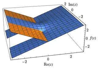

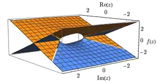

Now, we can rotate the two branch cuts independently of each other. Below is a plot that includes two Riemann sheets for this function. The trick to making two sheets here is to keep one of the square roots "on the first sheet" and move the other up one sheet. Here's what I mean. We'll plot these two functions: \begin{align} g_{\textrm{yellow}}(z)&= \operatorname{sqrt}\left(z+i;-\pi-\frac{\pi}{4}\right) \operatorname{sqrt}\left(z-i;-\pi+\frac{\pi}{4}\right)\\ g_{\textrm{blue}}(z)&= \operatorname{sqrt}\left(z+i;\pi-\frac{\pi}{4}\right) \operatorname{sqrt}\left(z-i;-\pi+\frac{\pi}{4}\right). \end{align} Notice that the only difference between the two is that the argument of one of the $\operatorname{sqrt}$ functions has increased by $2\pi$ to $\pi-\frac{\pi}{4}$. Here is the result:
