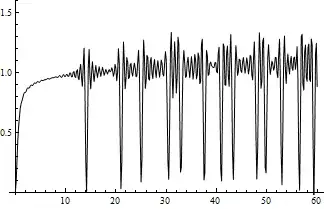

The plot of this function looks like this:
function

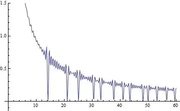

scale = 50; (*scale = 5000 gives the plot below*)
Print["Counting to 60"]
Monitor[g1 =
  ListLinePlot[
   Table[Re[
     Zeta[1/2 + I*k]*
      Total[Table[
        Total[MoebiusMu[Divisors[n]]/Divisors[n]^(1/2 + I*k - 1)]/(n*
           k), {n, 1, scale}]]], {k, 0 + 1/1000, 60, N[1/6]}],
   DataRange -> {0, 60}, PlotRange -> {-0.15, 1.5}], Floor[k]]

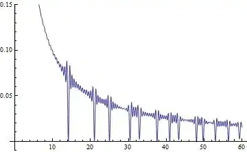

ListLinePlot[Im[errList]/Length[xlist], DataRange -> {0, 60},
 PlotRange -> {-.01, .15}]
Fourier transform:
zeta zero spectrum 2

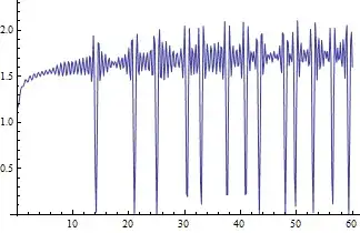

Matrix inverse:
Clear[n, k, t, A, nn];
nn = 50;
A = Table[
   Table[If[Mod[n, k] == 0, 1/(n/k)^(1/2 + I*t - 1), 0], {k, 1, nn}], {n, 1,
     nn}];
MatrixForm[A];
ListLinePlot[
 Table[Total[
   1/Table[n*t, {n, 1, nn}]*
    Total[Transpose[Re[Inverse[A]*Zeta[1/2 + I*t]]]]], {t, 1/1000, 60,
    N[1/6]}], DataRange -> {0, 60}, PlotRange -> {-0.15, 1.5}]

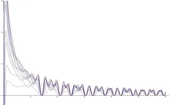

12 first curves together or partial sums:
12 curves

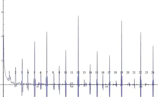

Clear[n, k, t, A, nn, dd];
dd = 220;
Print["Counting to ", dd];
nn = 20;
A = Table[
     nn}], {n, 1, nn}];
Monitor[g1 =
   ListLinePlot[
    Table[Total[
       Total[Transpose[
         Re[Inverse[
           IdentityMatrix[nn] + (Inverse[A] - IdentityMatrix[nn])*
             Zeta[1/2 + I*t]]]]]], {t, 1/1000, dd, N[1/100]}],
    DataRange -> {0, dd}, PlotRange -> {-7, 7}];, Floor[t]];

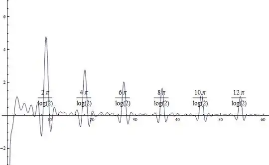

Clear[n, k, t, A, nn, h];
nn = 60;
h = 2; (*h=2 gives log 2 operator, h=3 gives log 3 operator and so on*)
A = Table[
     If[Mod[n/k, h] == 0, 1 - h, 1]/(n/k)^(1/2 + I*t - 1), 0], {k, 1,
     nn}], {n, 1, nn}];
MatrixForm[A];
g1 = ListLinePlot[
   Table[Total[
     nn, N[1/6]}], DataRange -> {0, nn}, PlotRange -> {-3, 7}];
mm = N[2*Pi/Log[h], 12];
g2 = Graphics[
   Table[Style[Text[n*2*Pi/Log[h], {mm*n, 1}],
     FontFamily -> "Times New Roman", FontSize -> 14], {n, 1, 32}]];
Show[g1, g2, ImageSize -> Large]
Matrix inverse of Riemann zeta times log 2 operator:
2 Pi div log2 spectrum

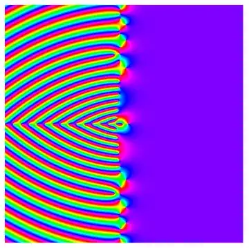

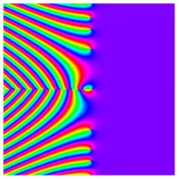

Jeffrey Stopple's code:
Show[Graphics[
  RasterArray[
   Table[Hue[
     Mod[3 Pi/2 + Arg[Zeta[sigma + I t]], 2 Pi]/(2 Pi)], {t, -30,
     30, .1}, {sigma, -30, 30, .1}]]], AspectRatio -> Automatic]
Normal or usual zeta:
Normal zeta

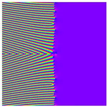

Show[Graphics[
  RasterArray[
   Table[Hue[
     Mod[3 Pi/2 +
        Arg[Sum[Zeta[sigma + I t]*
           Total[1/Divisors[n]^(sigma + I t - 1)*
              MoebiusMu[Divisors[n]]]/n, {n, 1, 30}]],
       2 Pi]/(2 Pi)], {t, -30, 30, .1}, {sigma, -30, 30, .1}]]],
Spectral zeta (30-th partial sum):
spectral zeta

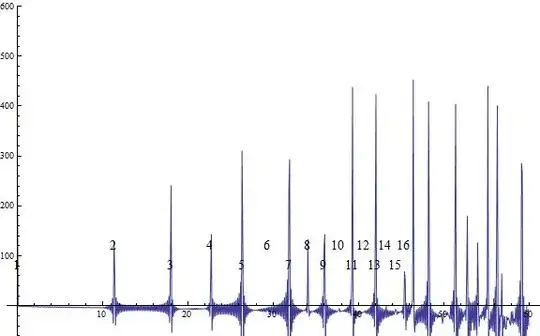

B = FourierDCT[
   Table[Total[
     1/Table[n, {n, 1, nn}]*
     600, N[1/6]}]];
g1 = ListLinePlot[B[[1 ;; 700]]*Table[Sqrt[n], {n, 1, 700}],
   DataRange -> {0, 60}, PlotRange -> {-60, 600}];
mm = 11.35/Log[2];
g2 = Graphics[
   Table[Style[Text[n, {mm*Log[n], 100 + 20*(-1)^n}],
     FontFamily -> "Times New Roman", FontSize -> 14], {n, 1, 16}]];

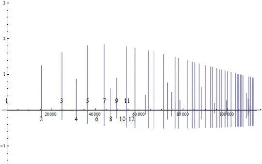

Edit 17.1.2015:
Clear[g1, g2, scale, xres, x, a, c, d, datapointsdisplayed];
scale = 1000000;
xres = .00001;
x = Exp[Range[0, Log[scale], xres]];
a = -FourierDCT[
    Log[x]*FourierDST[
      MangoldtLambda[Floor[x]]*(SawtoothWave[x] - 1)*(x)^(-1/2)]];
c = 62.357;
d = N[Im[ZetaZero[1]]];
datapointsdisplayed = 500000;
ymin = -1.5;
ymax = 3;
p = 0.013;
g1 = ListLinePlot[a[[1 ;; datapointsdisplayed]],
   PlotRange -> {ymin, ymax},
   DataRange -> {0, N[Im[ZetaZero[1]]]/c*datapointsdisplayed}];
Show[g1, Graphics[
  Table[Style[Text[n, {22800*Log[n], -1/4*(-1)^n}],
    FontFamily -> "Times New Roman", FontSize -> 14], {n, 1, 12}]],
 ImageSize -> Large]
