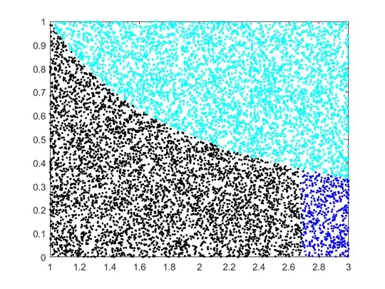

Draw $X_i \sim \text{Unif}(1,3)$ and $Y_i \sim \text{Unif}(0,1)$ for $i=1,\ldots,N$. Reject the samples where $Y_i > 1/X_i$. Sort the accepted $X_i$ values and take the $(N/2)$th.
This relies on the observation that $\int_1^e dx/x = 1$. So we do rejection sampling in the rectangle $[1,3] \times [0,1]$ to get points under the $1/x$ curve. By taking the $(N/2)$th smallest value we are finding the point where we have $1/2$ of the original points, that is, area $1$ (observing that the original rectangle has area $2$).
Here is the simulation with $N=10000$ points. The rejected points are in cyan. From the accepted points, the leftmost $N/2=5000$ are in black and the rest are in blue.
Monte Carlo estimation of e
    Nice! Here is a way to do this with way fewer rejections. Just generate $n$ iid points uniformly between $1$ and $3$, sort them so $1<x_1<x_2<\dots<x_n<3$, then use them as a mesh to approximate $\int_1^{x_i} dx/x$ with the midpoint rule. Keep increasing $i$ until the first time the approximate integral exceeds $1$. Then $e\approx x_i$. – Mike Earnest Sep 08 '21 at 21:19
    Mike, your solution is infinitely better than mine in terms of efficiency! I was striving to emulate the original "points in the disk for $\pi$" spirit as closely as possible. – Jukka Kohonen Sep 09 '21 at 06:26
