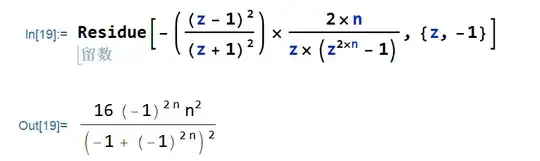

2. I tried to calculate this via Mathematica like this:[enter image description here]
If I let $n$ take concrete integers, say, $n=5$, we do get the right answer $-34$. However, it seems that we cann't get the right answer if we let $n$ be a variable. What's wrong here, how can we use mathematica to get a general answer (instead of concrete examples by letting n be some integers). I faced with this sort of problems in similar situations. Can you tell me what shoud I do, or just let me know that mathematica cannot do this! Thank you !

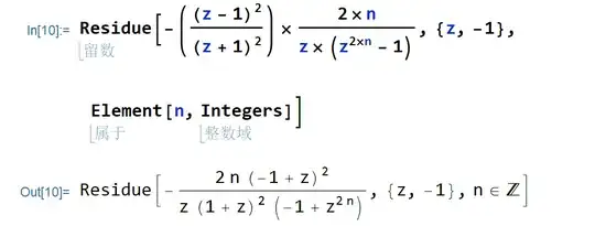

Addition As for Sangchul Lee's answer for my second question, I have another quesion. Why does the following code does not work, what's the difference between "Element[n, Integers]" and "Assumptions -> n \in Integers":enter image description here

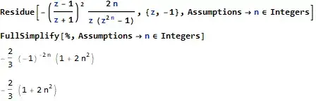

2. To compute this residue using Mathematica, you may do as follow:
mathematica code

  • I have another question concerning the second question. why this code fails:Residue[-((z - 1)^2/(z + 1)^2)(2n)/(z(z^(2n) - 1)), {z, -1}, Element[n, Integers]]. (you can see the result at the end of my post) What's difference between this with yours? – 王李远 Sep 03 '21 at 01:58
  • The last bit of Residue need to include Assumptions-> . Otherwise it's just an element not an assumption. @王李远 – Semiclassical Sep 03 '21 at 03:38
