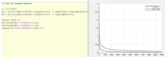

EDIT: Eldar has suggested the use of a computational approach to obtain the result. We observe a discrepancy when using MATLAB and Wolfram to do the analysis and that is most likely due to the convention used between the 2 softwares in the Fourier Transform operation.
