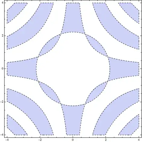

Clarifying Berci's idea a bit, suppose that $f:{\mathbb R}^n\rightarrow\mathbb R$ is any continuous function. Then $$\{{\mathbf x}: f({\mathbf x})>0\}$$ is an open set. This can be quite crazy. If $n=2$ and $$f(x,y)=\left(x^2+y^2-5\right) \cos (x \, y),$$ we get the following:
