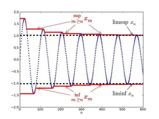

The most intuitive way I think is to try to understand what it is doing with a picture (credit Wikimedia Commons user Eigenjohnson): liminf-limsup
We know the maximum or minimum of a sequence may not exist, but the supremum and infimum always exist (if the sequence is bounded; if not we can consider the supremum/infimum in the extended real line as $\pm \infty$). However the supremum/infimum describes an upper/lower bound over the whole sequence, and so does not give us information about the tail of the sequence, or how the sequence eventually behaves. In the picture the supremum over the whole sequence $(x_n)$ is about 1.75 for early values in the sequence, but this doesn't tell us about later terms ($x_n$ for large $n$), which seem to have a supremum at 1.0.
$\liminf$ and $\limsup$ on the other hand tell us about the infimum and supremum as $n$ goes to infinity and we consider later and later $x_n$ terms. One definition (which I consider the most intuitive) is $$\limsup_{n \to \infty} x_n = \lim_{n \to \infty} \sup_{m \ge n} x_m$$
By the nature of this definition, we consider the supremum over the tail of the sequence of values $x_m$ or later, that is $(x_m)_{m \ge n}$, and by having the limit as $m \to \infty$ we consider later and later tails of the sequence. This captures the notion of best bounds of how the sequence eventually behaves for much later terms. Another nice thing about this definition is that $\limsup$ looks like $\lim$ of a $\sup$ and so we can remember what we're working with.

  • (+1) Wikipediua picture really helped me untangle it for me too. I personally found that the picture was even more intuitive if we drew the red lines so that they don't extend from the left hand y-axis to the relevant supremum, rather extend from the relevant supremum to the right-hand y-axis. – microhaus Jan 30 '25 at 18:54
